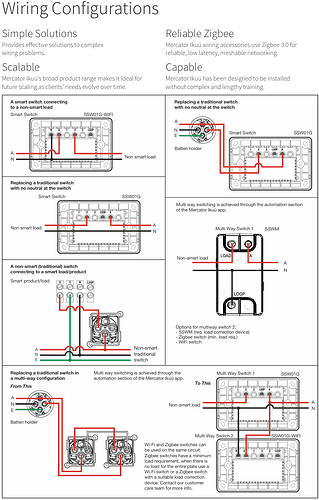

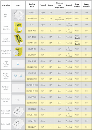

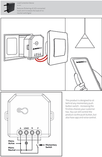

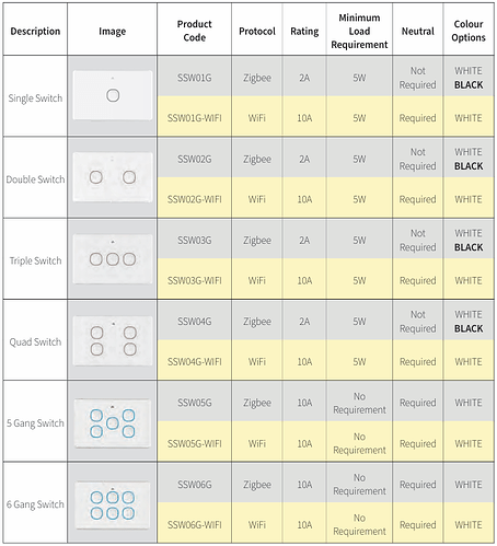

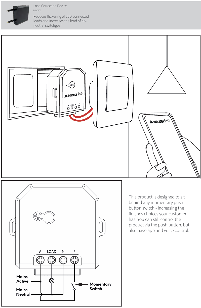

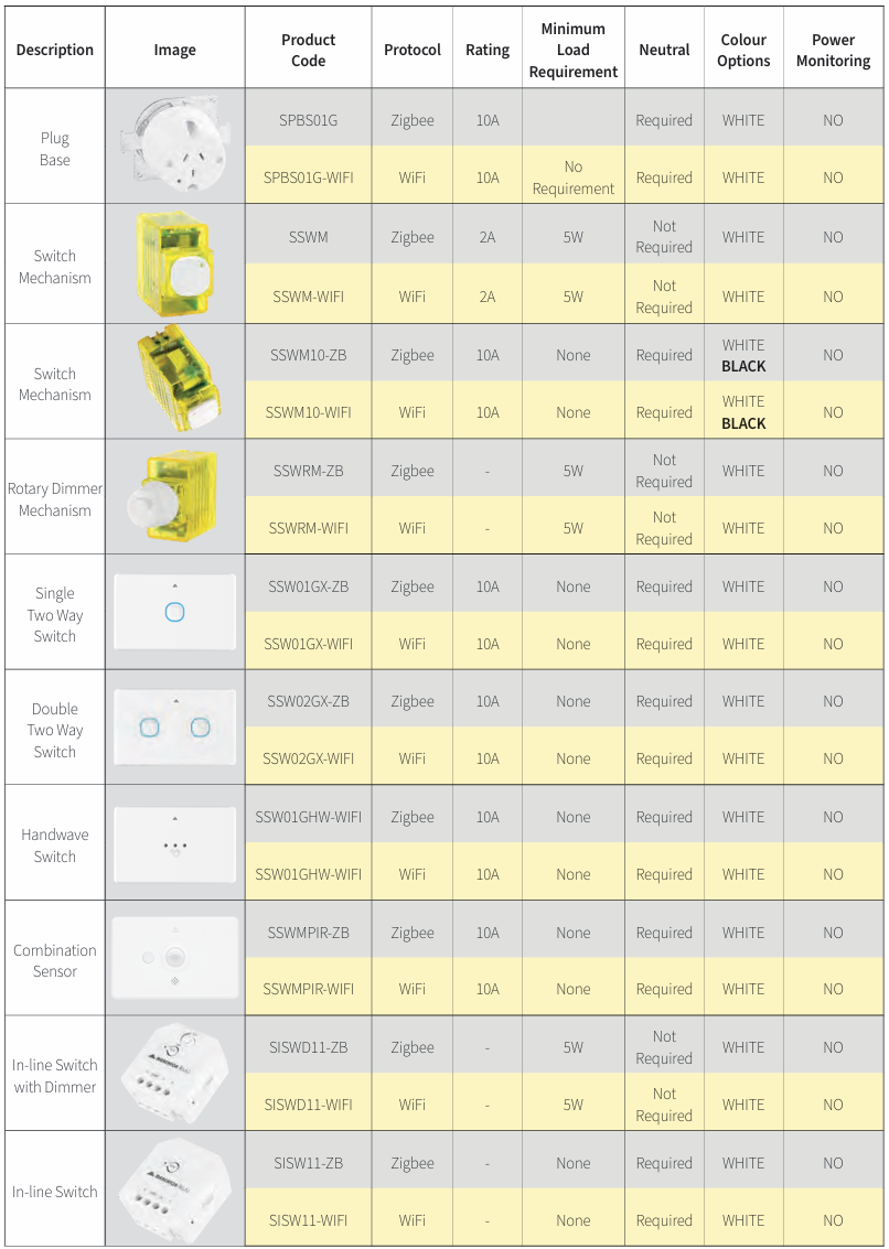

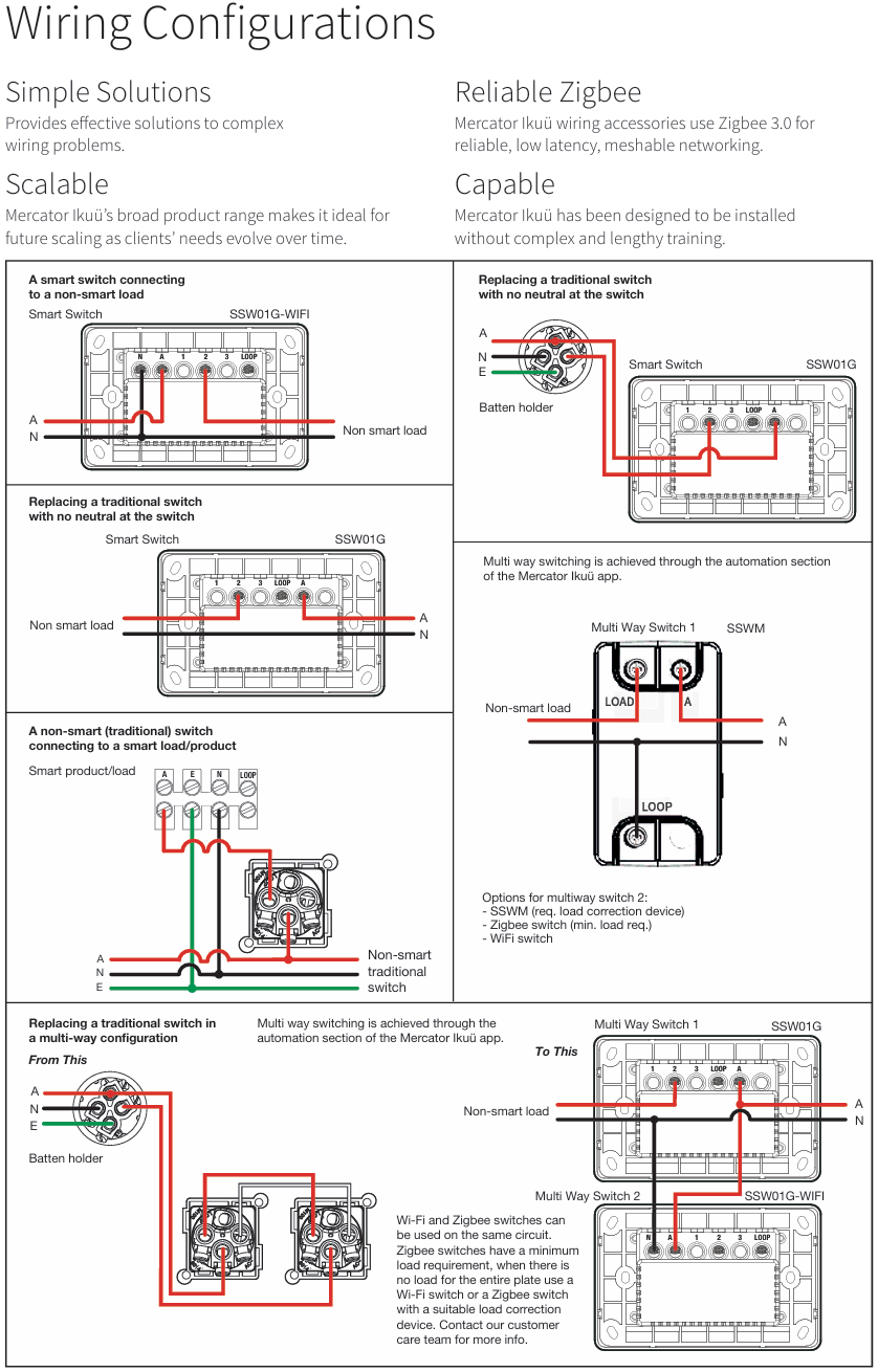

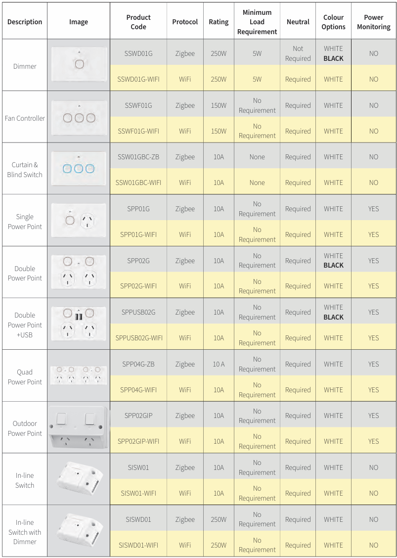

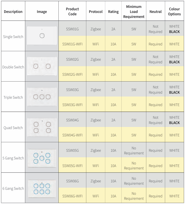

Rather than running a neutral I am most likely going to buy a whole new set of wall switches for the house.
I found these interesting charts and wiring diagrams for Mercator Ikuu products.
I have no neutral wire at my light switches, as I am sure most of you are in the same boat.
I am looking at the Zigbee devices that require no neutral.
  • Does anyone have any experience with these?
  • Is the 2A rating for the (No Neutral) Zigbee versions an issue, when compared to the 10A (Neutral Required) WiFi versions?
  • What does the minimum load requirement mean?
    • If I have a single light bulb at less than 5W, what will it do?
  • The highest power draw lighting circuit I have is 3-5 florescent lights on one switch. Unless incandescent lights draw more power.
