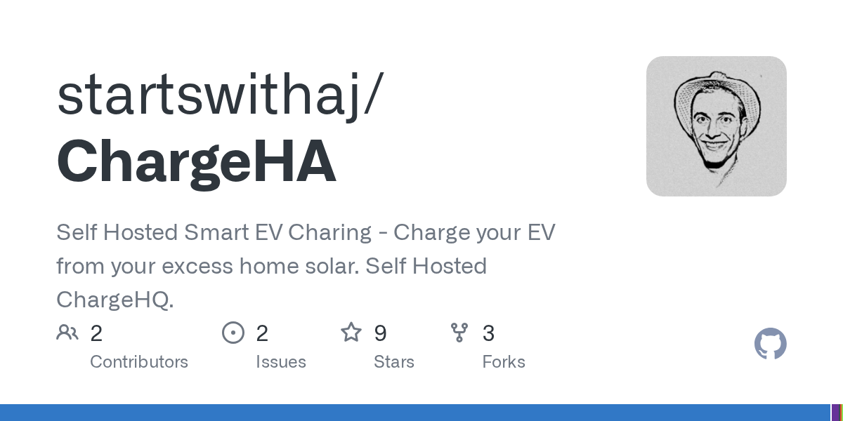

Else pretty much any OCPP unit can be managed with HA integration or via other services such as EVCC or a number of options popping up since the demise of ChargeHQ, like this one:
