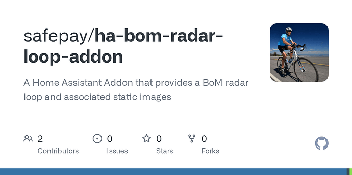

So I used this as a base:

The installation of the Docker component has now been simplified to a Home Assistant addon.
This makes installation a lot simpler and lets you focus on the AI prompt, which is the hard part.
Did this cost you $100million to develop? Grins!
