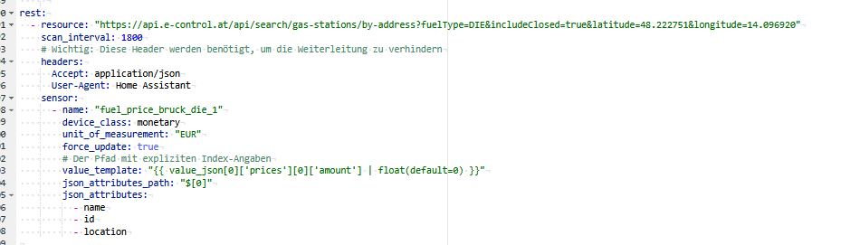

Hallo bin am verzweifeln… kann mir jemand sagen was ich hier falsch mache ?
bei mir kommt immer unavailable oder unknown …
There is a well known bug on this API page, and since this bug is still not fixed, you have to manually change the path from /api/ to /sprit/1.0/
like this:
- resource: https://api.e-control.at/sprit/1.0/search/gas-stations/by-address?fuelType=...
Since this bug is really old, every AI would have answered this question in the same way.
