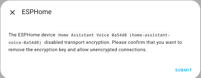

I received the HA Voice PE today, went through the setup and started to notice this warning.
Weirdly, the first occurance is being reported on one of the offline ESP devices. Figuring i had something else wrong i set the HA Voice device to a new IP, as DHCP reservation. The error changed to a DIFFERENT ESP device (also offline).
current error:
But when you actually click the repair message, it changes info to reference the HA Voice device:
Clicking submit will only make the error come back again.
HA Voice has not been “taken control” in ESPHome Builder at this point.
I’ve now just “taken control” in ESPHome Builder, repaired the message and after a few minutes the error comes back.
