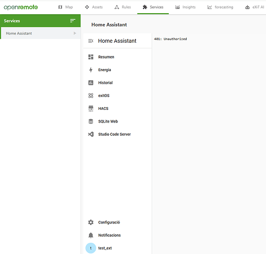

Greetings,
I have been trying to add Home Assistant as an external service to Open Remote, which by the looks of it, it worked. However, most of the actions rises a problem with not being authorized to do them, even if every time I access it I use my login credentials from Open Remote.
Does anyone know if its a thing from the browser, or my code? The error is: 401 Unautorized
Opening HA from the usual url (not using Open remote) works fine, but the moment I try to use it from Open Remote its like it does not allow me because I lack permission (even if I already logged in with the same user)
I have prepared a file to prepare the connection, which is:
