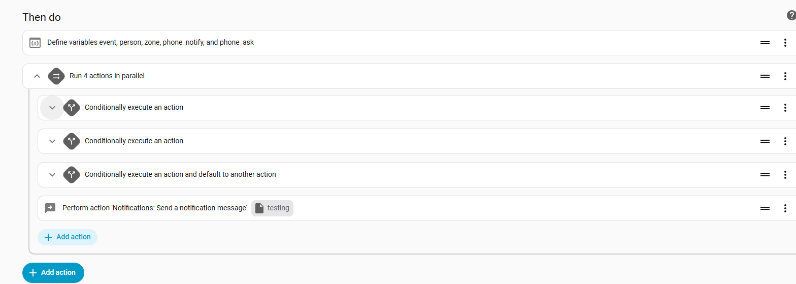

Well, that is what I thought you might have meant. But, I am not seeing what I think you describe.
Here is what I get when opening this automation
I have gone through all of my automations and don’t have any that have multiple first level actions. So, I may not see what you see. My sublevels do not expand automatically.
Am I missing something?

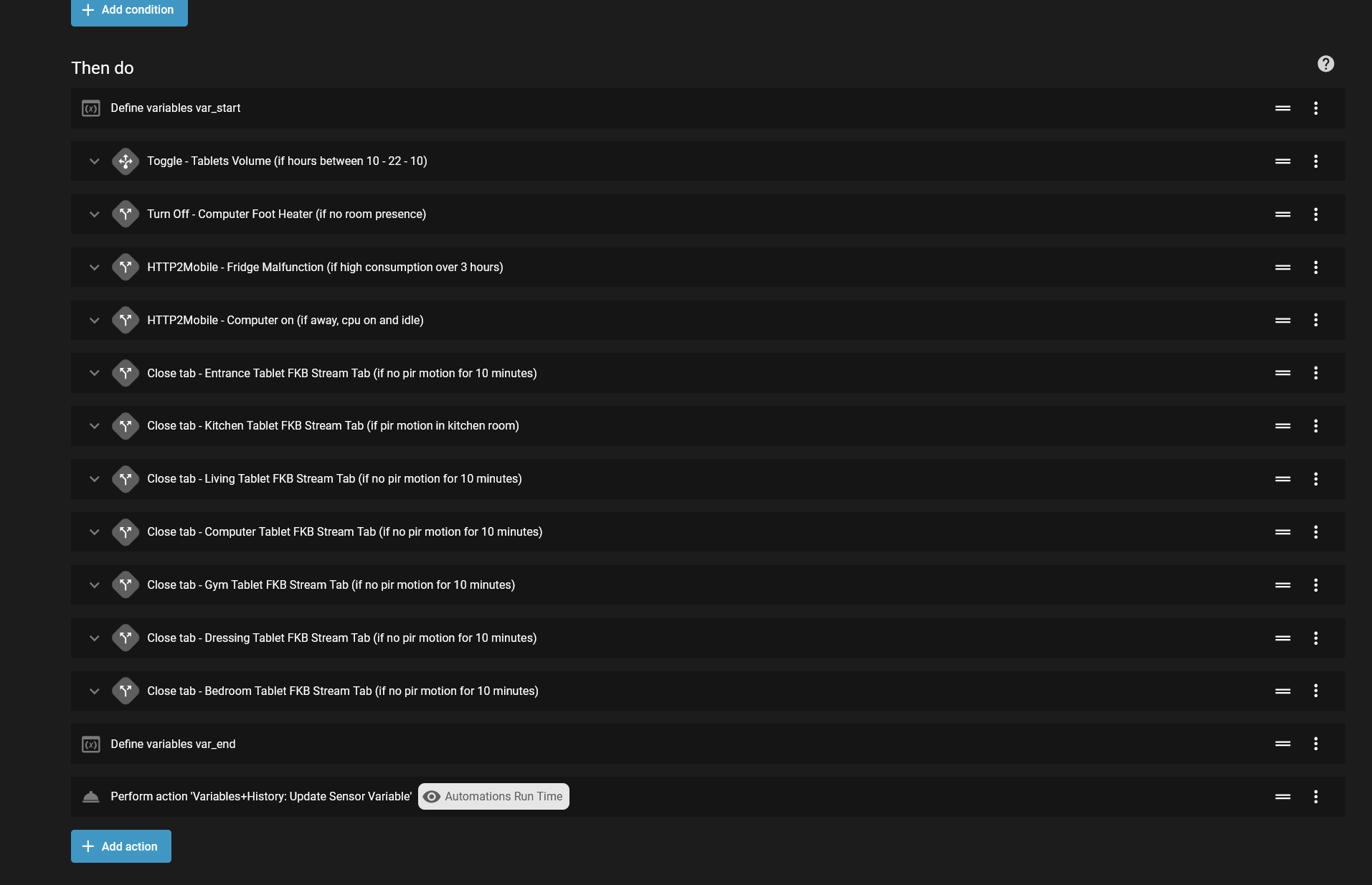

I am talking about the first level actions, take a look at one of mine. Imagine how it would look as all expanded
Gotcha. I get it.
