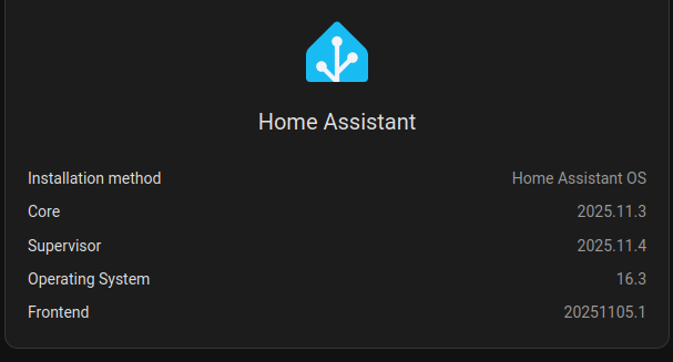

Hello Sean Wing,
Can you share what the top section of this says?
Similar to this:
