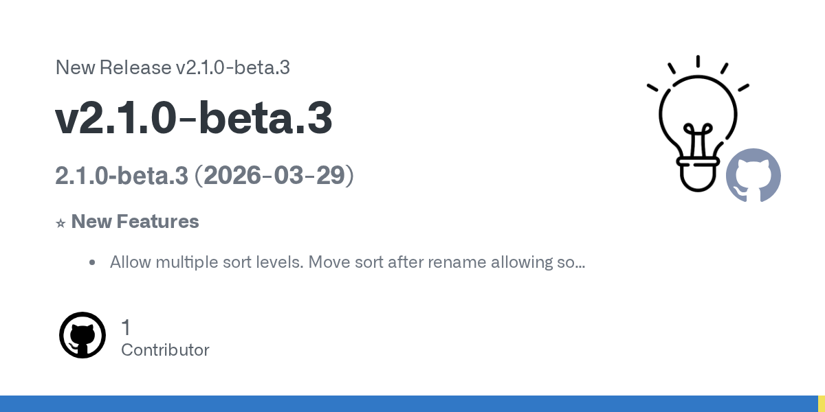

:mega: auto-entities 2.1.0-beta.3 available :mega:
2.1.0-beta.3 is available and includes state_translated for rename method and variable in eval_js (added in beta.2) and sort to support multiple sort levels and moved after rename (added in beta.3).

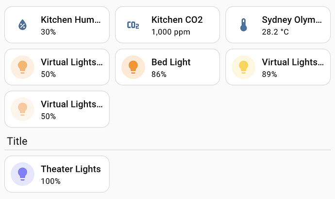

This can work, with two tweaks:
  1. Use type: heading
  2. Need to style the grid for the heading to use a full row CSS { grid-column: 1 / -1; }
Example below
Caveats:
  • the heading will be included as a count, so will always cause a-e to show, even if show_empty is false (types of section and divider don’t get counted when counting up generated entities).
  • sorting overall is going to break title position of course, but that is the same with divider, section

Thanx Alot, I Finally got something, thou without a Line

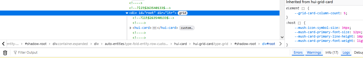

In FireFox Inspect ?
Add your desired border to hui-card:has(.type-heading) { }. My example had border-bottom: 1px solid var(--divider-color)
Yes, in cosole. Highlight to element you want to style, which will be $0 in console, then use uix_path($0).
Yes i did copy it but as i didn’t see any line , i removed it ( Maybe i have to check my Theme)
EDIT, yep that must be it, i just change the var to primary-color
Try the good ol red or something. Perhaps you have styled out divider-color.
Hmmmmm, i only know howto find the various elements by clicking
So you explanation says me nothing
I.e
When i click highlight, and click the element, then what i don’t see anything in Console, and where /what do i use $0Ā“vs uix_path($0) in there inspect/console ?
Im totally blank here :blush:
Two things:
  1. What you click on becomes a special console variable $0.
  2. So you run uix_path($0) in console to run uix_path on highlighted element.
I clearly have no idea what im doing , or how to use inspect and ā€œconsoleā€ what ever you mean by Console, nor howto/where to ā€œrunā€ something
As said, i can just ā€œtraverseā€ the ā€œstructureā€ and/or click an element , maybe it’s different(easier to understand) in another browser than FF , because i totally don’t know what you mean
where do i see this ?, the ā€œusualā€ path below in the inspect window ?
