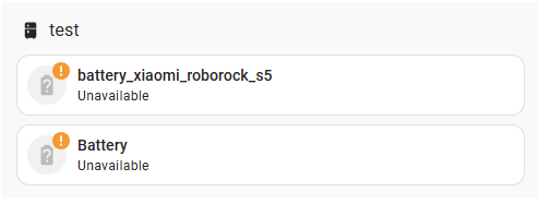

I would like to have a list of unavailable entities with a heading. Then hide the whole card, including heading, when empty. I can’t seem to get it quite right.
This shows and hides the heading correctly (tested with filters I know are empty), but for some reason no entities appear when there should be results:
type: custom:auto-entities
card:
  type: vertical-stack
  cards:
    - type: heading
      heading: test
      icon: mdi:fridge
      heading_style: title
filter:
  include:
    - attributes:
        device_class: battery
      state: unavailable
      options:
        type: tile
card_param: cards
show_empty: false
This shows the entities and the heading correctly, but when empty still shows the heading:
card:
filter:
  include:
    - type: heading
      heading: test
      icon: mdi:fridge
    - attributes:
      state: unavailable
      options:
        type: tile
card_param: cards
show_empty: false
Anyone have any ideas?
The code is wrong, you cannot merge 2 lists:
  • a list of cards containing only the ā€œHeading cardā€;
  • a list of ā€œTileā€ cards.
If you need to create a list of cards containing a FIXED card + DYNAMIC cards - you need to add that fixed card inside the ā€œfilterā€ like here:
card:
filter:
  include:
    - domain: sun
      options:
        type: heading
        heading: test
        icon: mdi:fridge
    - attributes:
      state: unavailable
      options:
        type: tile
card_param: cards
show_empty: false
Thanks for the speedy reply.
I still have the heading when the filter is empty. Is there anyway to hide the heading card when my filter returns no results?
