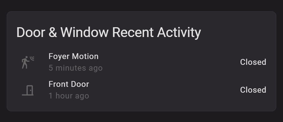

Labels (Include and Exclude) - doesnt work
… still broken? the issue was closed a while ago
Name / Friendly Name (exclude) - doesnt work (can use ID, they are zone names)
Templates - that was a mess, it never worked as it seems to conflict with the Include.
Here’s the code without the template…
type: custom:auto-entities
card:
  type: entities
  title: Door & Window Recent Activity
  show_header_toggle: false
  state_color: true
filter:
  include:
    - label: Door
    - label: Window
    - attributes:
        last_tripped_time: < 1h ago
      options:
        state_color: true
        secondary_info: last-changed
  exclude:
    - label: Motion
sort:
  method: last_changed
  reverse: true
show_empty: false

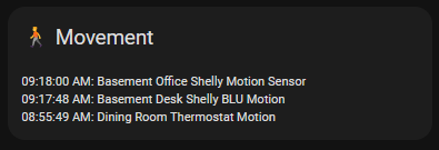

I got mine working for motion sensors (I have more than 20 of them), but the distance between each line was too much, and the value was just ā€œDetectedā€ which is of minimal use, so instead I used a markdown card that works in the same manner, but actually shows the exact time with most recent one on top, and the description, and if there is no motion - a single line message ā€œCurrently no motion detected.ā€. (I guess I could add some code to hide the card altogether instead in that case.) In my opinion, this is much more elegant (and takes up much less space):
Here is the code -
type: markdown
title: 🚶 Movement
content: >
  {% set motion_sensors = states.binary_sensor
     | selectattr('entity_id', 'match', '.*motion.*')
     | selectattr('state', 'equalto', 'on')
     | sort(attribute='last_changed', reverse=true)
     | list %}
  {% if motion_sensors | length > 0 %} {% for s in motion_sensors %} {{
  as_local(s.last_changed).strftime('%I:%M:%S %p') }}: {{ s.name }}
  {% endfor %} {% else %} Currently no motion detected. {% endif %}
yes, a nice feature of Markdown.
did you consider labels (it will be nicer on the system to only ā€˜watch’ the labeled entities in stead of the whole states
content: >
  {% set motion_sensors = label_entities('beweging')
     | select('is_state','on')|list %}
  {% for s in motion_sensors|expand %}
  {{as_local(s.last_changed).strftime('%I:%M:%S %p') }} : {{ s.name }}
  {% endfor %}
  {% endif %}
personally, I use
{{as_local(s.last_changed).strftime('%X') }} : {{ area_name(s.entity_id) }}

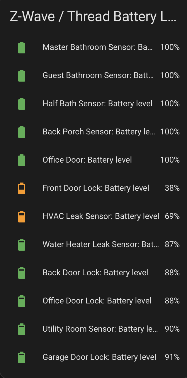

This has been a long standing issue for me, but since the dashboard plugin seems to be getting some development time, I wanted to see if I could get this resolved. I want to order entities by numeric state. However, the sorting seems to not convert the states into numbers, and is instead ordering them as strings.
This happens in two places within my dashboards:
The battery levels one is the most straight forward to look at:
card:
  type: entities
  state_color: true
  title: Z-Wave / Thread Battery Levels
filter:
  include:
    - domain: sensor
      name: "*: Battery level"
  exclude: []
sort:
  method: state
  numeric: true
  reverse: false

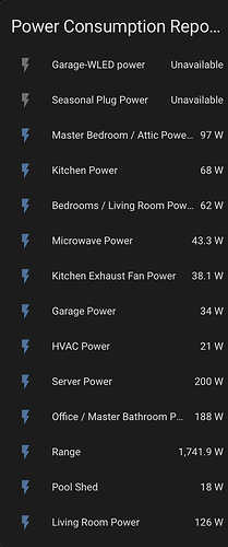

The power consumption is similar, but has many exclusions (redacted most of them):
card:
  title: Power Consumption Reporting
  type: entities
sort:
  method: state
  reverse: true
  numeric: true
filter:
  include:
    - attributes:
        unit_of_measurement: W
  exclude:
    - entity_id: sensor.inverter_*
    - entity_id: sensor.current_*
    - entity_id: sensor.all_standby_power
    - name: .*\(Hidden\)
    - state: <=15
