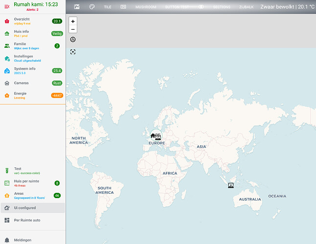

ive added this now:
type: custom:auto-entities
entities:
  - zone.home
  - zone.festspielhaus_bayreuth
  - zone.griya_seni_ekalaya
show_empty: false
filter:
  include:
    - entity_id: geo_location.*
  exclude:
    - attributes:
        source: wwlln
card:
  type: map
  fit_zones: true
and the zones below home make the map zoom out per addition. the bottom one is on Java, and makes the panel look like this
in preview UI editor
and in the panel itself, which admittedly is a bit ugly because of the map size not fitting the view size.
take either of those out, and it re-sizes accordingly
