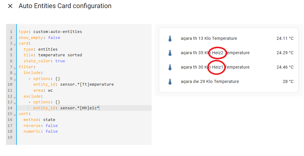

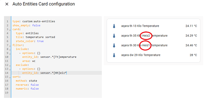

i use auto-entities to filter entites by room, what is working great.
but with my temperatures devices i don´t want to be listed all of them and i want to exclude all with “Heiz” in name, but it does not work?
what do i make wrong?
thanx

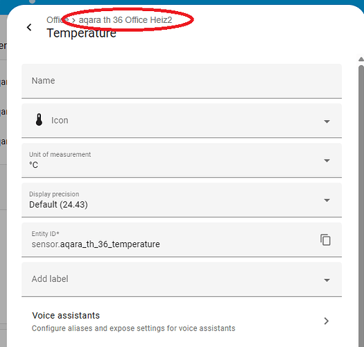

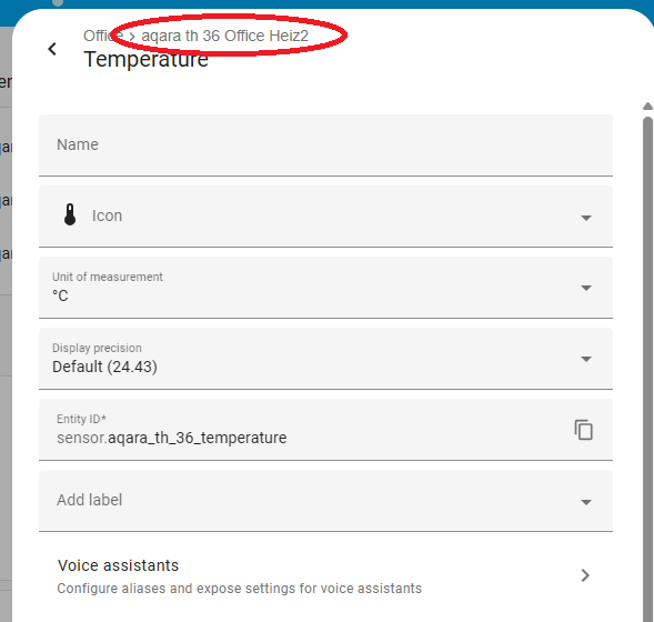

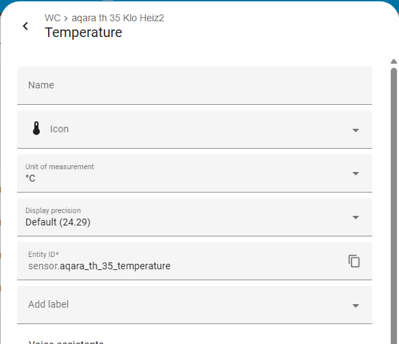

no, i don´t use names, but your hint showed me what´s wrong… i don´t have this info in the entity ids? but where does it come from? it is display in cards and every where.
i had created this device names with zigbee2mqtt and renamed devices (once with entity ID and once again without changing entity ID to give it a sepaking name) it is called friendly name in zigbe2mqtt… but in device info it is not name?
