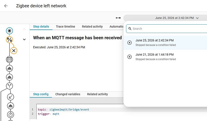

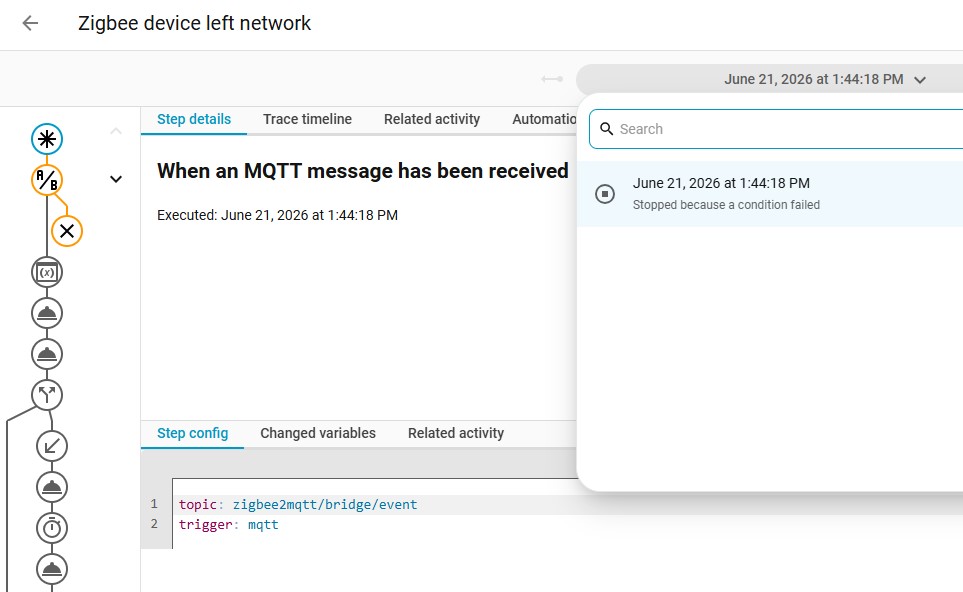

Every event from every Z2m device will hit this trigger and fire that automation. Are you sure you want to do that?
Its an automation. Just create a new automation and dump the yaml.
No, I'm not sure. I really don't know enough to say one way or another. Claude helped me get through it. I looked at traces and the last time the trigger was hit was yesterday, so it doesn't seem to be a problem. The one in the screenshot failed the template condition: {{ trigger.payload_json.type == 'device_leave' }}, so obviously it did not run. But there doesn't appear to be a ton of traffic hitting the trigger.

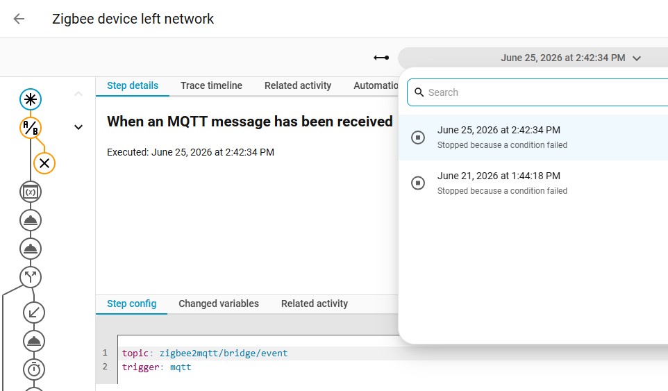

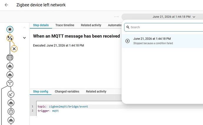

Will check how much traffic this creates but the trigger didn't fire yet in the first 15 minutes.
Yeah, very little traffic. Only 2 times firing in over a week, which is a little surprising considering we had a very short power outage yesterday.
[edit - not sure how complete that traces drop down box is, but either way, its not getting hammered]

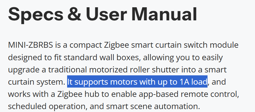

Had a look at the reviews & it seems to be a common problem. That's besides other issues, like the relays not actually closing when reaching the end (0 or 100%) & the fact that they only support a 1A load, which might be an issue if your motor doesn't have built in limit switches & the relay keeps running.

Motor specs are good. 0.6A with mechanical limits. FWIW, auto calibration worked fine on all of them.
