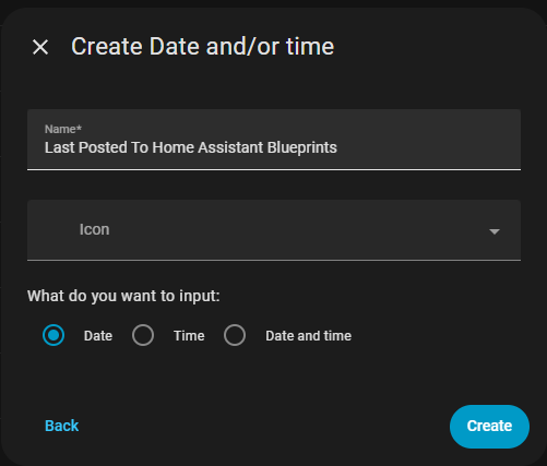

  2. Add a Date Helper and set the date you last completed the change/task.
  3. Make sure to set the value on this helper. You could use today’s date or a date in the past if you want the todo/task to trigger immediately.

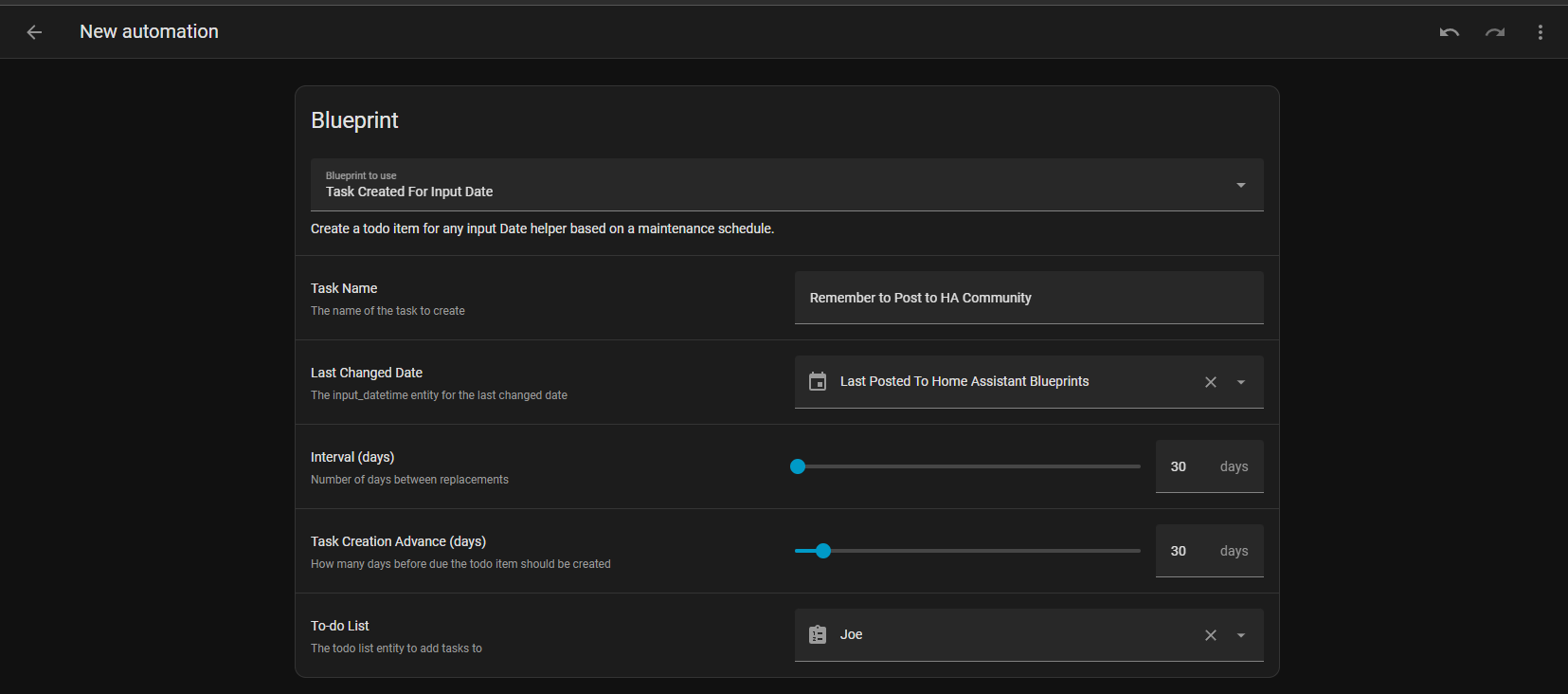

  4. Use the blueprint to create the automation:

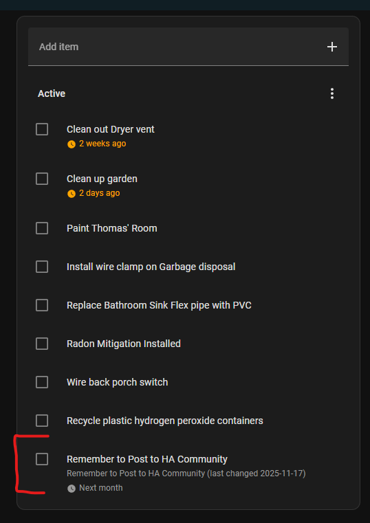

This will set a Due Date “Interval Days” from the date of the helper. The Task Creation Advance setting tells how many days in advance to setup the todo task. So if you wanted the task to be created 2 weeks before it’s due, then you’d set this to 14 days.

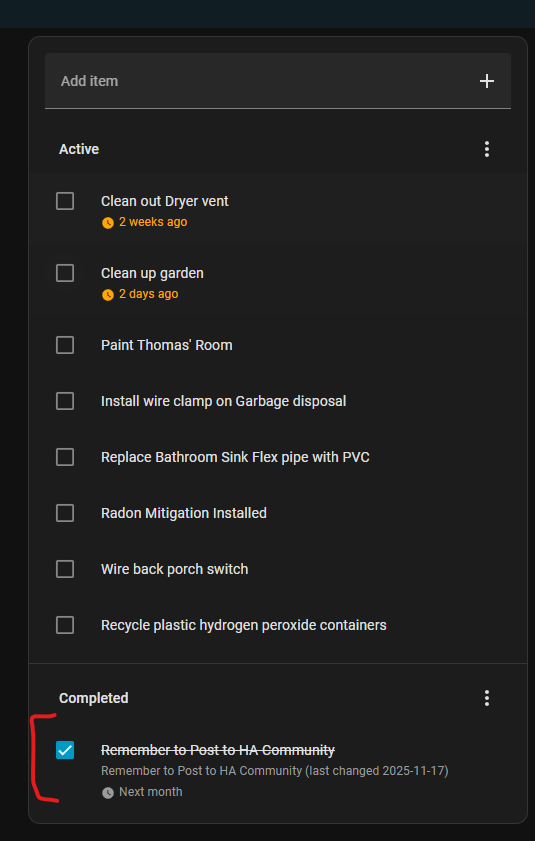

The script will run whenever the helper is changed to automatically complete tasks (Say I did my post to home assistant, I don’t need to update the todo list, I can just update the date helper to today and then the task will complete because it’s no longer inside the bounds of the reminder dates).

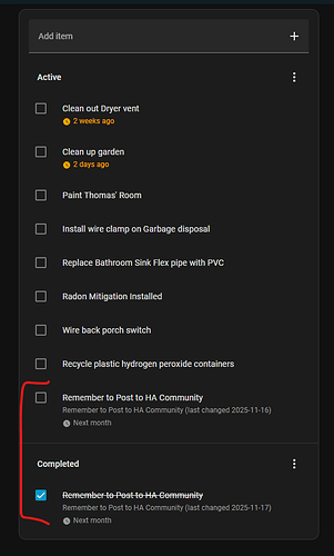

Caveat if you set the Interval Day
After updating date helper:
Once the daily task falls back in range, it will kick again (ok I set the date back to yesterday to get it to kick again… but you get the point)
