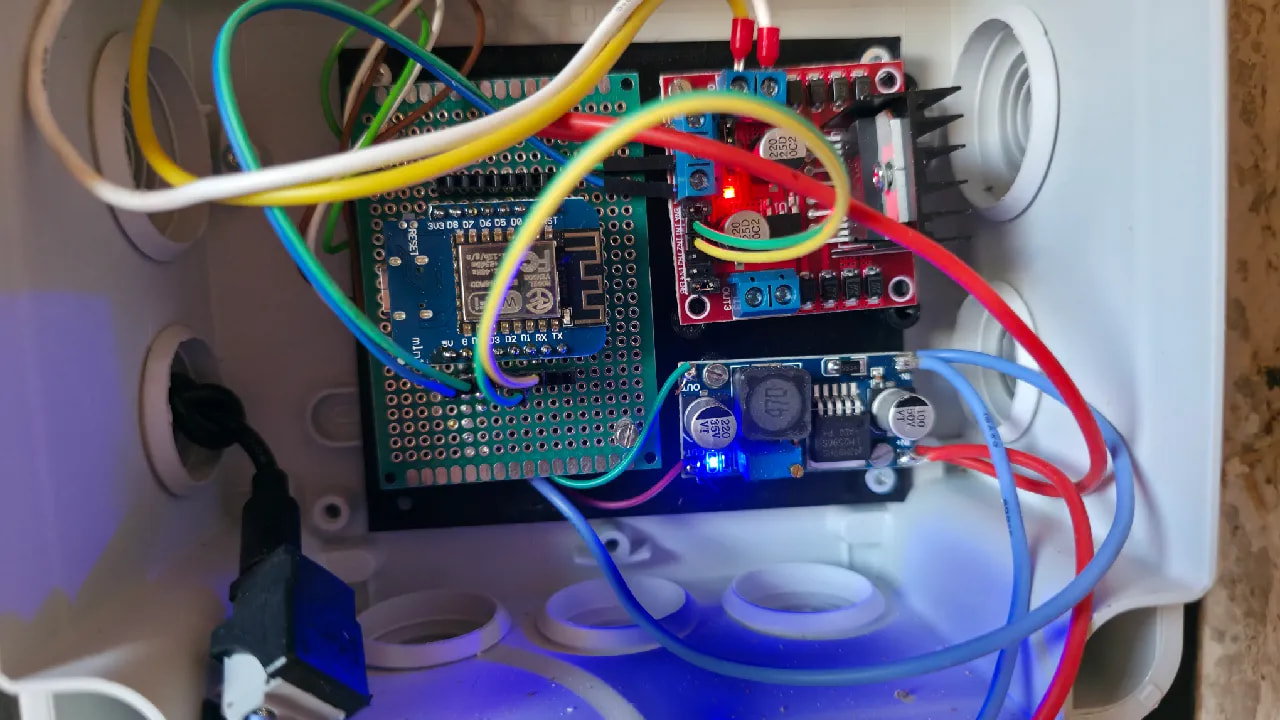

To move the cover up and down, a worm-gear motor is used, due to its selflocking feature. The motor is controlled via a L298N H-Bridge.

The following pictures show the wiring diagram of my control unit.

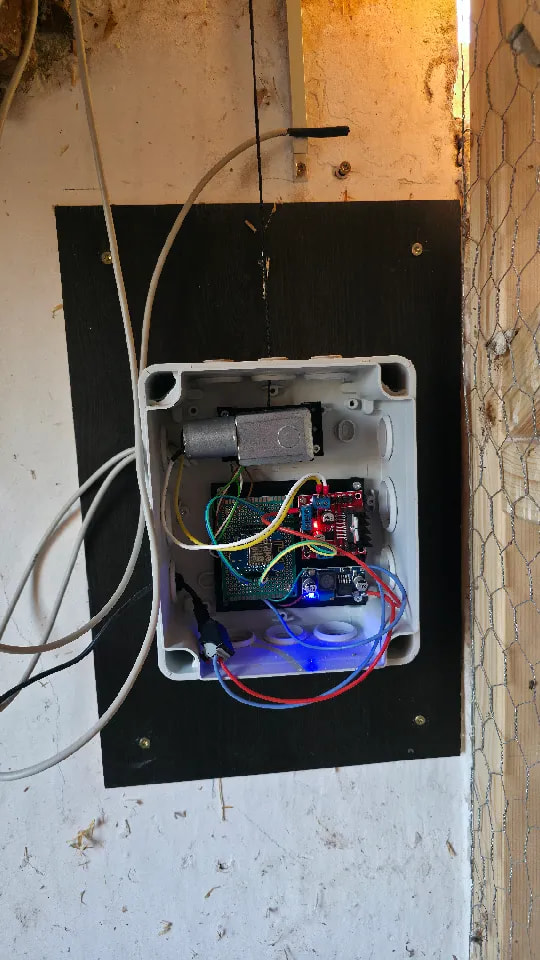

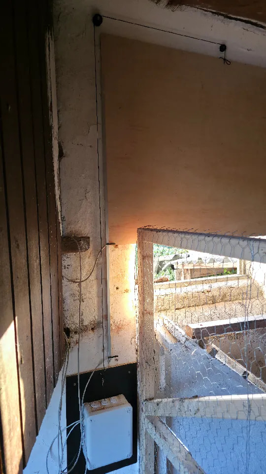

Excellent project, but I can’t see how the physical connection to the door works. Any chance of more info?

The door is connected with the thin black rope (first picture) to the winch inside the wet junktion box. The winch is hidden behind the motor. This happend due to the fact, that the outlet of the junktion box only fitted the rope like this.
