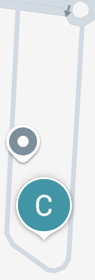

I have a question. I only want the gate to open if I am driving home from the road going down on the left. On the right is my front yard and so if we drive there, we will leave the car on the street. Also, if I get in the car in front of my house, I do not want the gate to open.
Any way to accomplish this in the automation? or anyone has a clue on how to accomplish this?

For your first issue, maybe you could edit the blueprint manually to add a stopping point if you are located on the wrong road while arriving (you could add a zone there, or maybe read the street name attribute from Waze).
However, since both roads seem really close to your house, the blueprint could open your gate before you even arrive there…
For this reason I don’t think there is a viable solution, but maybe someone else could help you.
And for your second issue, the “optional sensors” category could come in handy. You can either put an iBeacon near your gate and enable “Only open while near iBeacon”, or instead add your wifi sensor to “WiFi devices”, which has the same behavior, but over wifi. (maybe I should rename these inputs to make them clearer)
