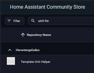

I have installed the integration from your repository successfully.
I have rebooted HA as requested.

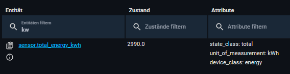

Here are the attributes of my sensor, maybe to_unit needs other attributes to work with?
state_class: total
unit_of_measurement: kWh
device_class: energy
The states(...) function only returns the value (without any reference to the unit or its original state), hence only a number is handed over to the to_unit filter. Use the followint instead
{{ states.sensor.total_energy_kwh | to_unit(‘Wh’) }}
