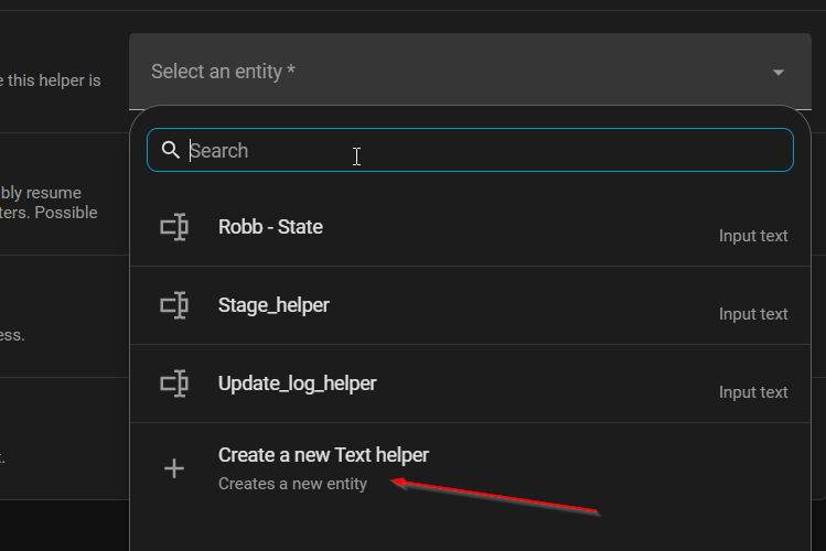

is there a template for the helpers? maybe in a little yaml :slight_smile:
What do you mean ?
Something to make the helpers ?
Yes so that they are the way they should be. :slight_smile:
You can when you make the blueprint easily create a new helper, if you click on the select an entity it also suggests to create a new 1
just give it a name so its easy to identify
oh crab i complitly read over this… sorry

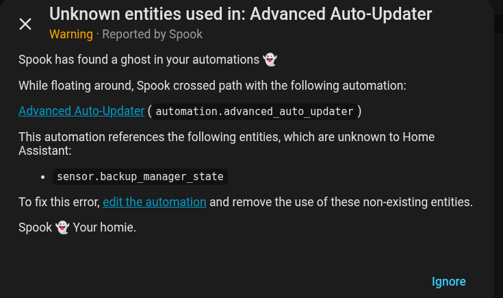

is there a way to use “telegram bot” as a notification? because notify.telegram is not availible.
and additional i recived this error:
@Artropos
Did you have an idea how o can use the new telegram integration as notification. and did you know the error from spook?
Thanks in advanced.
