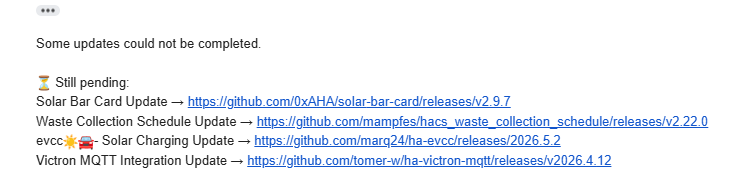

i was a bit to early after the new blueprint it worked like one ore two times and after that i am only getting emails like this:
i use it in 2 different HAs and it stoped working on both :frowning: sorry
anything i can help you with the troubleshooting?

Those are all HACS integrations which require a restart after an update. They possibly were updated previously and are still waiting for a restart to be applied properly.
I suspect the new updates can’t be installed before the older updates are applied. Check your settings or repairs screen - you’ll probably see a notification telling you that you need to restart to apply the updates.
hey there is no restart pending:
its just the updates

What happens if you manually start the update ?
it worked. and they are installed

For me it is not running fine I now have an update since yesterday for an add on and it is not getting updated. What can I provide to finde the issue?

Did you install the latest blueprint ?
It has error detection, it writes it in the HASS loggs
Would love to help you to find the root cause to make the blueprint better.
  • 5.2.0: Added detailed failure reason logging to system_log with level
    error. Failed updates now log entity state, installed/latest version, and
    timeout info. Uses logger
    homeassistant.components.automation.advanced_auto_updater for easy
    filtering.
