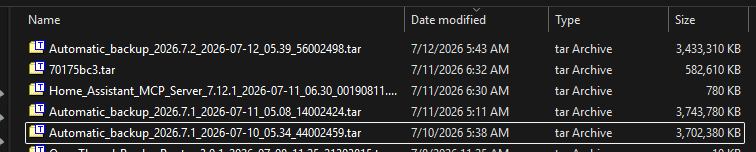

Pretty sure these nearly 4GB backups are the full backup right? Seems to be working the way I expected :slight_smile:.

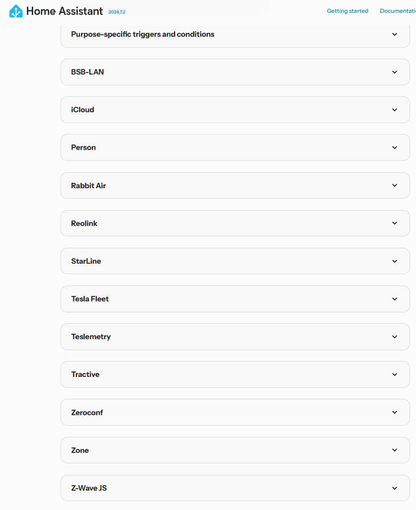

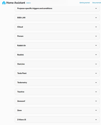

This is really the only thing you need to read.
If any of it impacts you, then you click on it and read some more.
But I agree, it just doesn’t make sense to have HA and not read 22 words.
