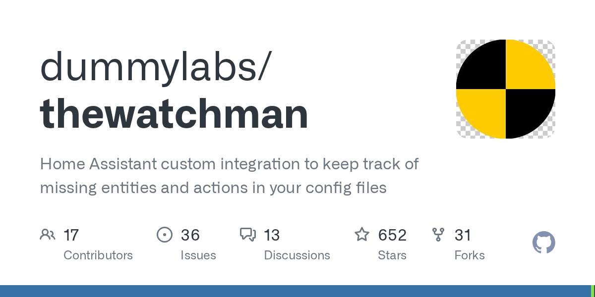

I use spook too (is good at UI based things), in combination with Watchman, which does the same for yaml based files with regard to finding broken entities.
