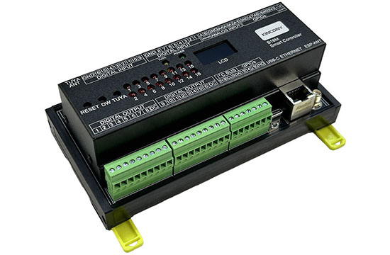

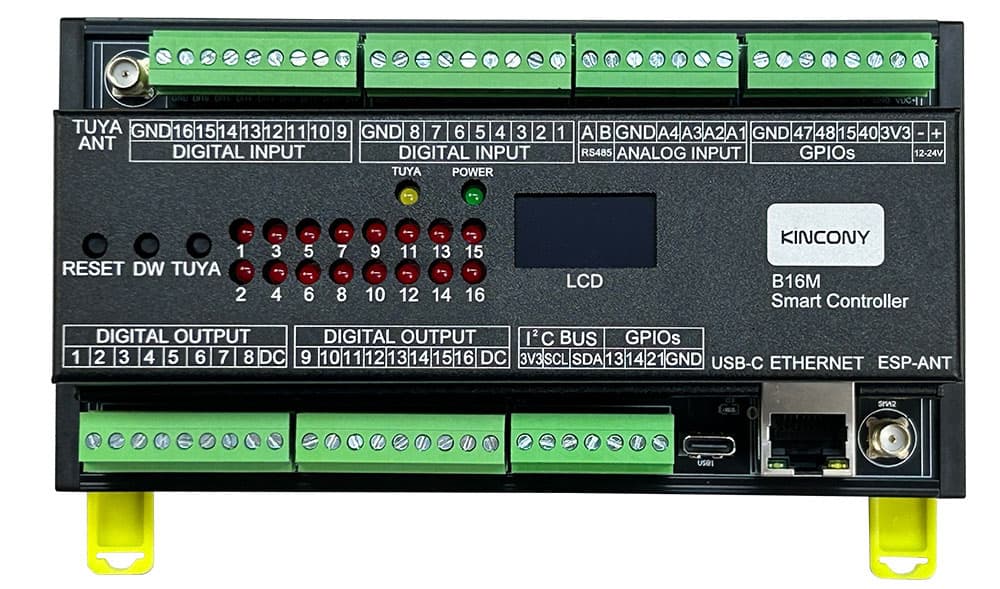

The system works with niko switches (momentary press) that are connected to dry contact inputs. The software allows met to link these inputs into one or more outputs or groups, create scenes. I was thinking to wire the push buttons into a KinCony B16M which is integratable with HA over mqtt. So button > mosfet > domintell dry contact. This way I could controll the inputs of the domintell system from my physical buttons and HA and HA would be able to read them. Would this work - any other suggestions (I do not have AC wiring to my wall switches, only low voltage cable to the distribution box).
DISM04/08/20 can not be driven by MOSFET or any other semiconductor ouptut stage. So you cannot create a kind of follower by making DIGITAL_OUTPUT follow DIGITAL_INPUT (NIKO button->DIGITAL_INPUT_n->HA automation->DIGITAL_OUTPUT_n->DISM0x) :cry:
An possibility would be to connect a 5VDC/12VDC coil relay to DIGITAL_OUTPUT_n and the dry contact output of the relay to the DISM0x and inject a 5 or 12 VDC voltage to DIGITAL_OUTPUT_DC terminal.
If think that Finder has relays that can be installed on DIN rail. Or you can use another HA compatible relays module to forward
NIKO button->DIGITAL_INPUT_n->HA automation->DIGITAL_OUTPUT_n->Relay coil->Relay output->DISM0x

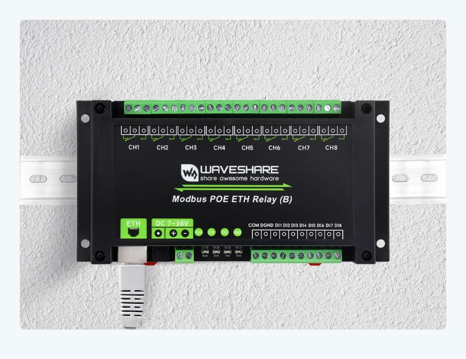

Instead of KinCony, you could try a Waveshare module that seems more suited for what you want to achieve (but of course, it may need more investigation).
Connect your Niko button to DIn and the DISM0x wires to CHn and link them thanks to the using HA automation
It seems that CHn can be directly controlled by DIn depending of the configuration.
I do not have this Waveshare module but it should work.
