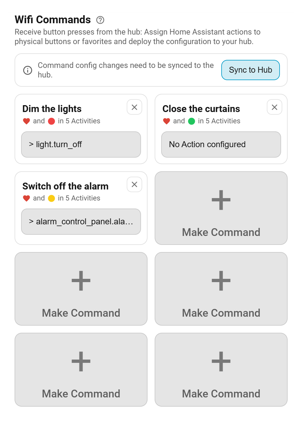

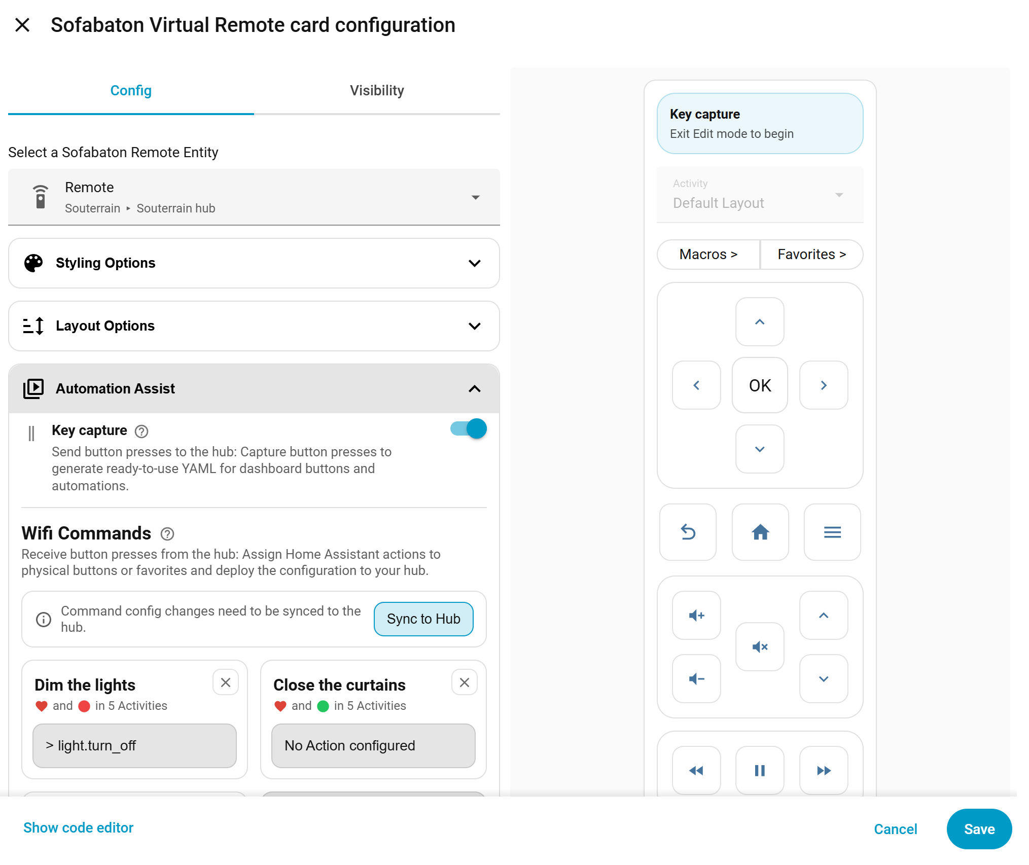

I’ve been building a Lovelace card for Sofabaton remotes (X1, X1S, X2) and added a feature I’ve been working on for a while: Wifi Commands.
Press a physical button on your remote → something happens in Home Assistant. Configure it entirely through the card UI.

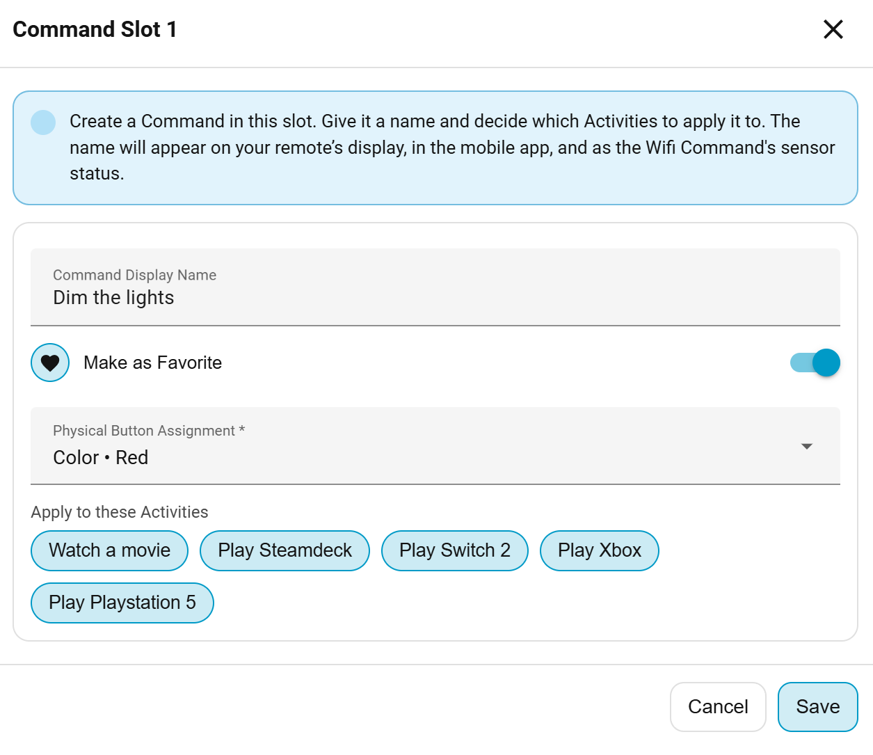

You give a command a name, assign it to a button or favorite, pick which Activities it applies to, optionally attach a HA Action (turn off lights, close curtains, whatever), and sync to the hub. Done. All Sofabaton hubs supported.
If you prefer to wire things up yourself, you can skip the Action and trigger your own automations from the sensor.<hub>_wifi_commands entity instead.
Full docs are here

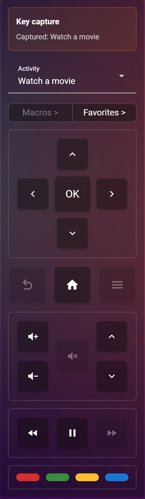

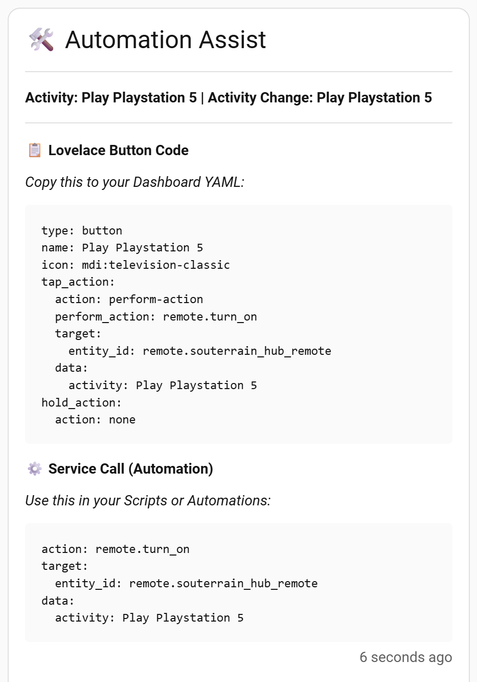

The card also has Key Capture for the other direction - press buttons on the virtual remote and get ready-to-use YAML in your sidebar, for both Lovelace button cards and automation actions. Useful if you’re not sure what the right remote.send_command call looks like.
See how to use here.
