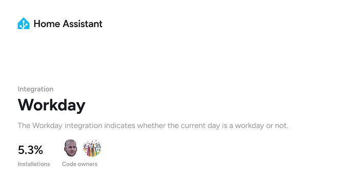

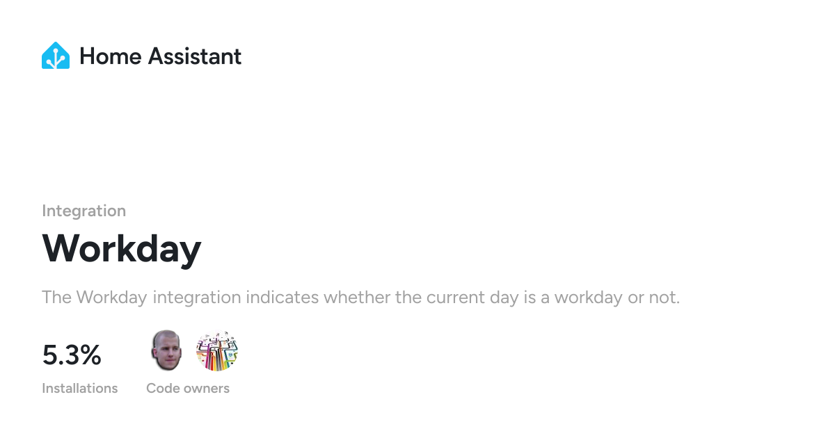

While the previously-linked Workday integration is okay for a first-pass method, it only provides a binary output and it’s not easy to modify its output for those random, one-off events. For example, the calendar it provides does not allow adding or editing events from the Calendar dashboard.

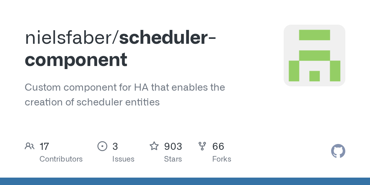

Annuals: This custom integration uses the same library for holidays that Workday uses, but is more flexible. So, it may be helpful if you need to incorporate holidays.
I have found this integration to be very helpful with my scheduled tasks and events.
