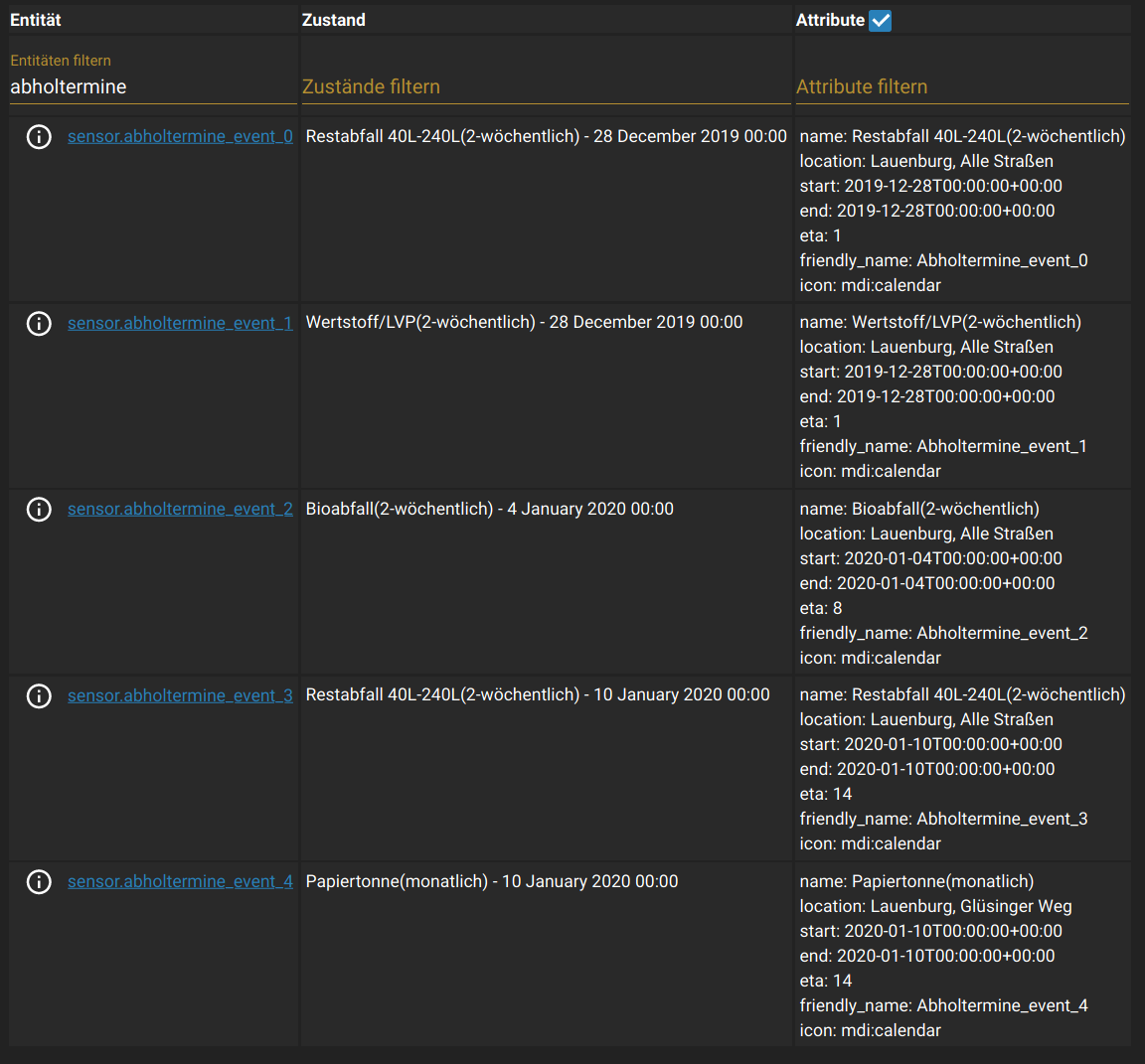

That will create these entities:
Those are sensor.abholtermine_event_<n>, where n is 0 - 4; so I got five upcoming events. Unfortunately (for me), these events all start at 00:00:00, which means that the eta state attribute will also always change at midnight. So triggering it then will do me no good!

I just manually triggered this, and received Trash Pickup Abholtermineevent0, Abholtermineevent1; however, I should get Trash Pickup Restabfall 40L-240L(2-wöchentlich), Wertstoff/LVP(2-wöchentlich) (these two events both have an eta of 1).
Is this because I manually triggered this, or what could be the reason? Here is the content of sensor.abholtermine_event_0
name: Restabfall 40L-240L(2-wöchentlich)
location: Lauenburg, Alle StraĂźen
start: 2019-12-28T00:00:00+00:00
end: 2019-12-28T00:00:00+00:00
eta: 1
friendly_name: Abholtermine_event_0
icon: mdi:calendar
manual trigger shouldn’t make a difference. What’s the state of all 5 etas?
I set the trigger to 16 instead of 17, so I just got the same message a couple of minutes ago with the same result. These are the states
  • 1
  • 1
  • 8
  • 14
  • 14
Ok, so it’s just not outputting the friendly name.
