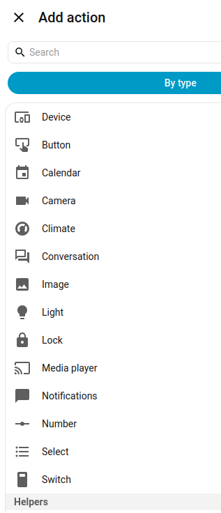

You can use entities in the UI too: they’re just not presented as the primary option. Select Switch (bottom of list) rather than Device.

As to the IDs, this is what it looks like in the editor with your new option added (both mine and the new actions are there for reference only):
In the YAML it looks like this:

I get the distinction in my head, but I don’t understand the difference from the editor’s point of view.
