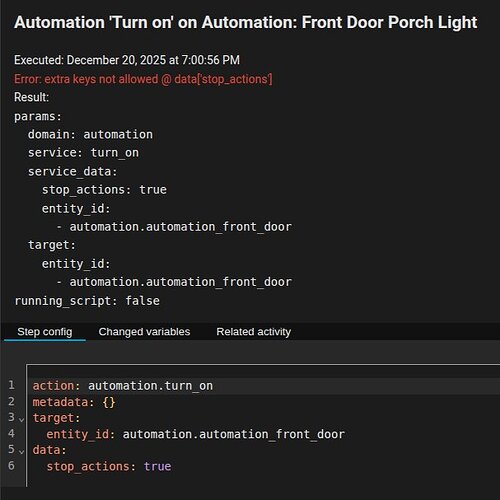

The first part of the porch light activation is working fine. The second part for deactivation also works for the most part but when it gets to the second last part “action: automation.turn_on” the code breaks and I see following error in the traces:
I’m not really sure how to fix it and any pointers will be appreciated!
Thanks.
automation.turn_on does not accept stop_actions: (that’s likely the extra key), only automation.turn_off does as per the Automation actions docs.
@HappyCadaver thanks, that does the trick!!
