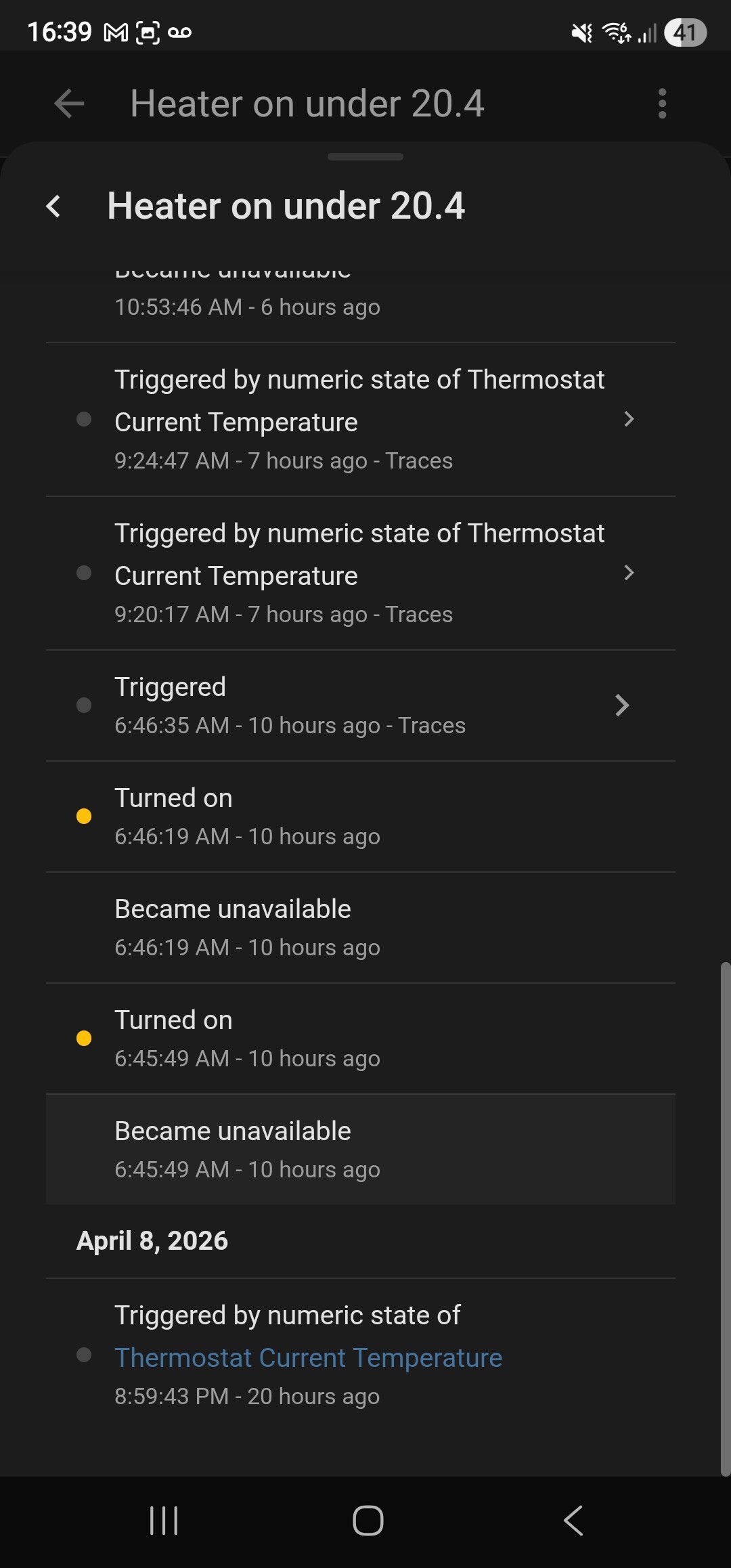

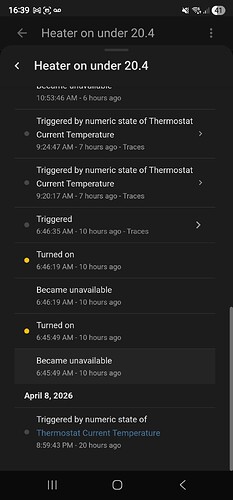

I have a simple automation but doesn’t work properly for some reason. Once the battery level drops below 65 the turn off trigger properly but when battery goes above it doesn’t turn back anymore. I get a became unavailable message. Once I trigger it manually it works fine until it drops again or the day ends. It doesn’t start in the morning either, only manually.
Any ideas?
See screen shots
