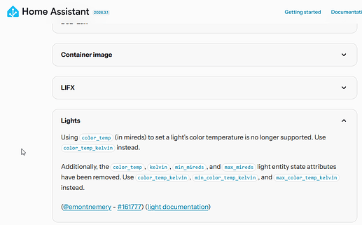

Remove deprecated light features | Home Assistant Developer Docs

But the thing is, I never added color_temp in an automation. I just created an automation, saw that it worked, and that was the end of it.
I know it was deprecated, but I never used that property to my knowledge. I saw it mentioned in the changelogs some time ago, but I literally never gave it any thought, because I never used it.
So how was I supposed to know that the UI buries this property somewhere in the automations? And why was this not fixed automatically as part of an update?
