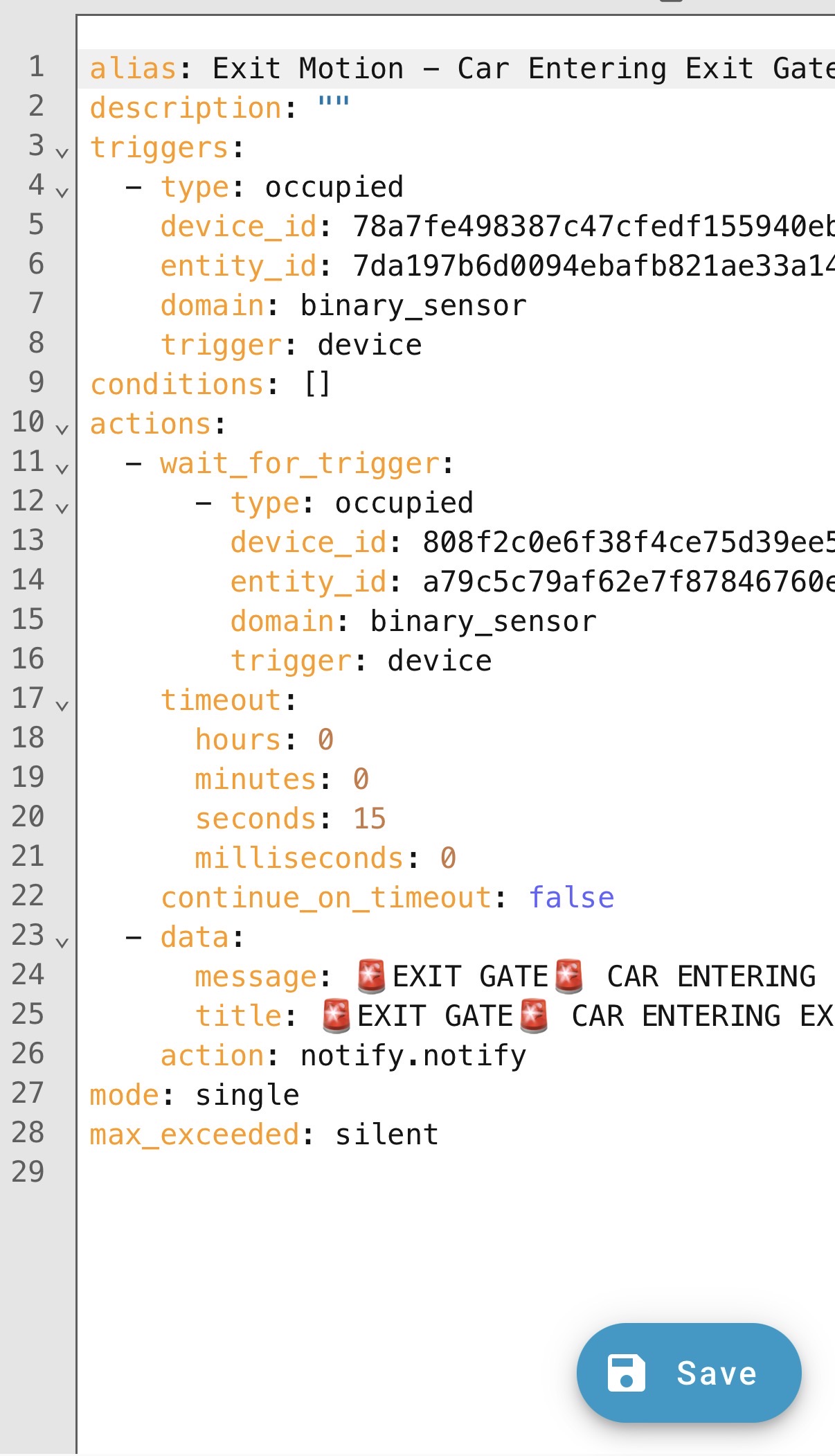

Hi. How can I create an automation for if motion 1 is triggered, and then motion 2 is triggered within x seconds of that, then whatever actions occur.
I’m trying to do the standard when motion 1 is triggered “And If” motion 2 is triggered, however I can not figure out a way to have any kind of “within x seconds” criteria doing it this way.

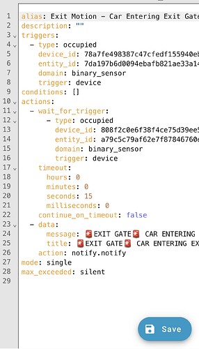

Thanks so much for the reply. I will try that. Curious, is there a difference between doing the sensors as “state” like you did above vs like this:
Yes.

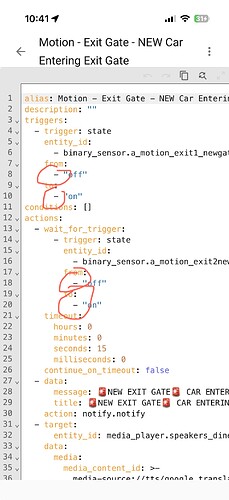

One thing I noticed is that when I made the change it put hyphens like this. What do the hyphens mean? Thanks!
It’s how you define a list in YAML. Here’s a list with 4 items.

The from and to options can accept a list containing multiple items. In your example, it’s a list with 1 item.
Why didn’t Tom’s first YAML example above have hyphens, and HA put hyphens in mine?
Also, are they just for human reference or do they have an effect in HA?
Thanks!
The Automation Editor follows its own set of rules for YAML formatting. Basically, it represents values in list format if the given option supports lists.
from supports a list value so the Automation Editor represented the single value off as a list containing one item.
The Automation Editor understands these two examples but will ultimately represent them in YAML list format.
