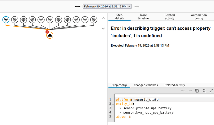

Trace:

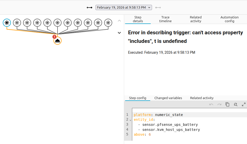

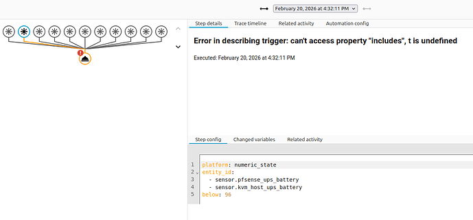

This is very odd…that fires the automation, but it prints out nothing:

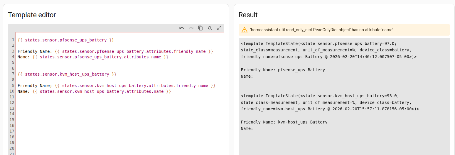

And if I print out in the template-dev tab both of the entities that could potentially trigger that numeric-state automation, it looks like both of them should have friendly names:
Why would that need a default-check to print out the name of the thing that fired it?
That isn’t required anywhere else I have ever done a numeric-state triggered alert in my automatons.
Well that was my mistake. Sorry.
Should be: {{ trigger.to_state.name }}
However name is not an attribute of your sensor. It is a property of the trigger state object. So it won’t resolve in your template editor test.

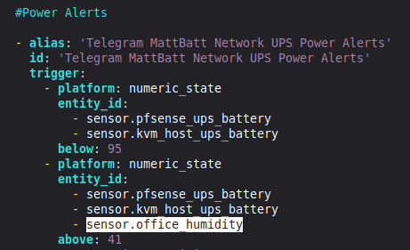

Also I just did a test adding a different sensor and that fires, so it seems like it only is failing to fire correctly on friendly_name when its the apcupsd integration sensors?:

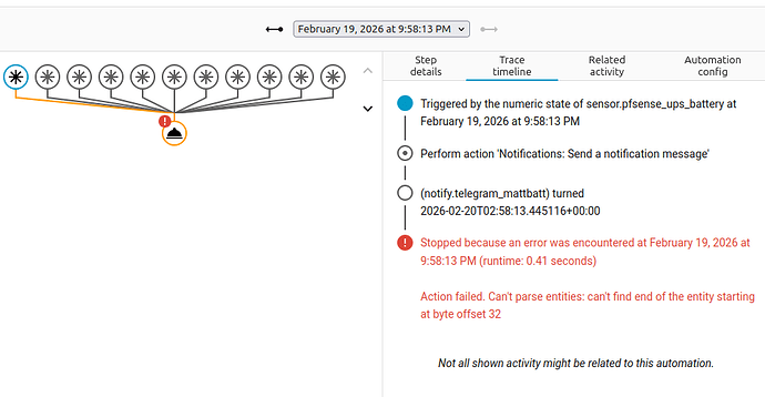

No change when its triggered by the UPS battery % numeric condition.
    action:
      - service: notify.send_message
          entity_id: notify.telegram_mattbatt
        data_template:
          message: |
            UPS Power Alert:
              Check {{ trigger.to_state.name }}
            pfSense Core Network UPS:

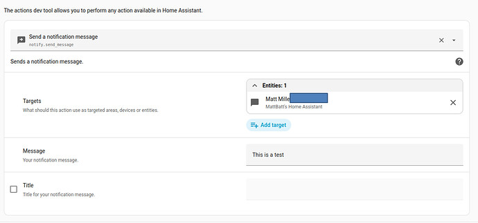

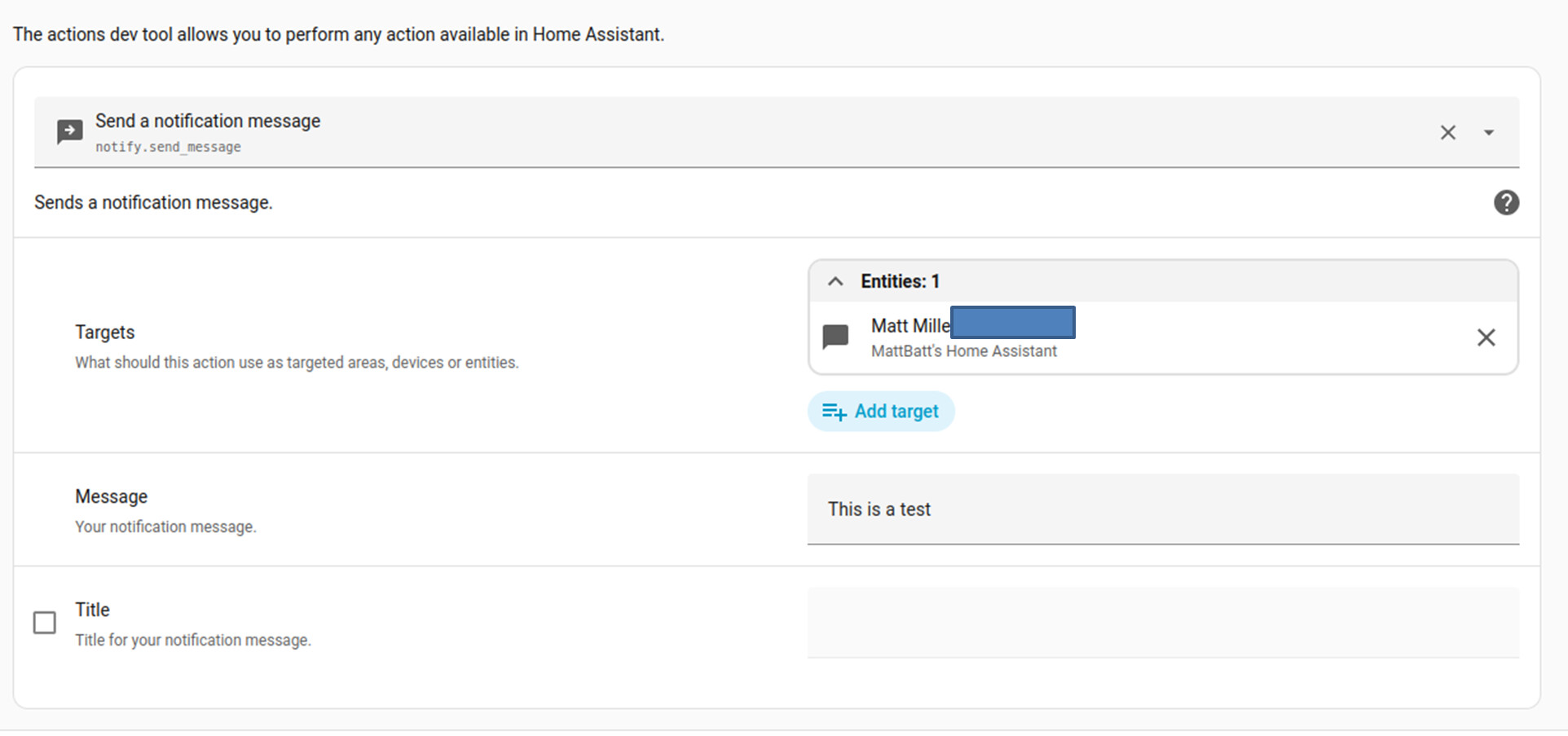

When I do a Telegram send message within the GUI action builder dev tool, it seems to generate the syntax I am already using for messages?
And clicking “switch to YAML” it shows (I do admit, I changed the _1234567890 to “me” for privacy when posting):
action: notify.send_message
  entity_id: notify.telegram_me
  message: This is a test
Though since I’m using a template not fixed-string text, everything I could find for guides seems to say I need data_template: not just data:?

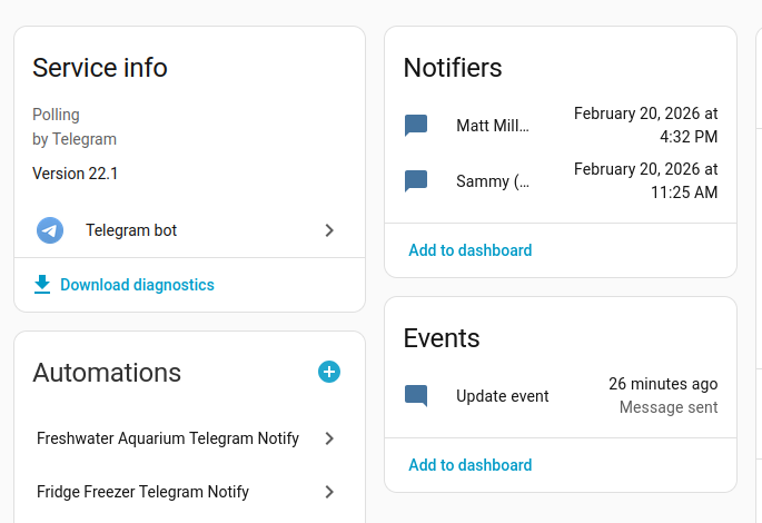

Go to Settings → Devices & Services → Telegram bot. All your chat ids are listed there.
My example was to a group.
But the id could also be for a single user.
I don’t have a link, but that’s what I found reading thru these forums. No idea how long ago, I don’t keep a log of every of the millions of pages I have gone to.
I don’t see anything on the doc you linked that talks about messaging a USER, only chat groups and replying to interactions. This is not what I’m doing, I’m direct messaging a specific user. All I have is the user’s username and user ID that was set up thru the integration.
I also can’t find any way to add something thru the GUI that would let me tie a “chat ID” to a user to let me pick from that. Its not reasonable to have to put the user’s ID everywhere in every automation and have to keep separate track of who that is for.
When I go to the Devices & Services → Telegram bot I only see the notifiers which is what I just got done converting things over to?

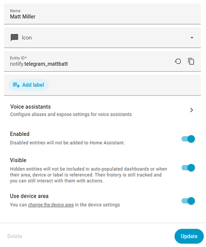

What do you see when you click on the Matt Mill… entity then click on the cog icon in the pop-up?
It looks like maybe if I paste a user’s user-ID into the “chat ID” that can trigger a message in the dev tools but that also is not really managable.
How then could you tell apart who’s messaged by which automation when you have more than one user? Is 1234567890 or 098765431 me? It needs to be something sensible named set up in one place thru the integration, not a random number with no context spammed thru every single automation, and that if it has to be changed will be a major nightmare to untangle.
I’m not familiar with what “telegram bot webhooks” means.
I renamed mine in the GUI because I would never remember the random numbers it put by default in the name/entity ID - that way I can reference a human-readable name in automations instead of a long random string of digits:

I’m not convinced that’s related to my current issue though. I’ll try and build a test automation with the different syntax to see.
