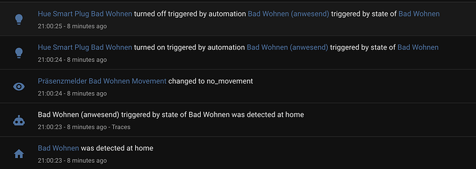

Probably a dumb question, but I couldn’t find anything here or on search engines about my exact problem. I have an Aqara FP1E presence detector installed in a room and I want to switch on a smart plug when presence is detected but the automation that turns it on seems to turn it off after a few seconds even though presence is still detected according to the FP1E.
My expectation was that it only turns the plug on, not off.

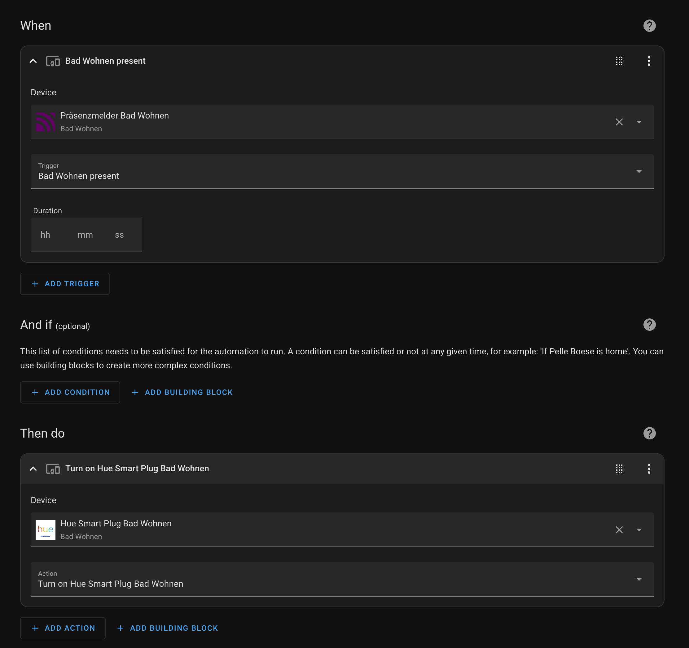

Here’s my automation:
alias: Bad Wohnen (anwesend)
description: ""
triggers:
  - type: present
    device_id: 2c092faf6ca795ad0696e46125c28e98
    entity_id: b2e3c076a4d2fb02881e7f7188ffa7f6
    domain: binary_sensor
    trigger: device
conditions: []
actions:
  - type: turn_on
    device_id: 74ba56b540a0b81fe97746e14da7ba60
    entity_id: c4cc4e7cc332e4676f2f5c3072d42d0d
    domain: light
mode: single
Or, more visual:

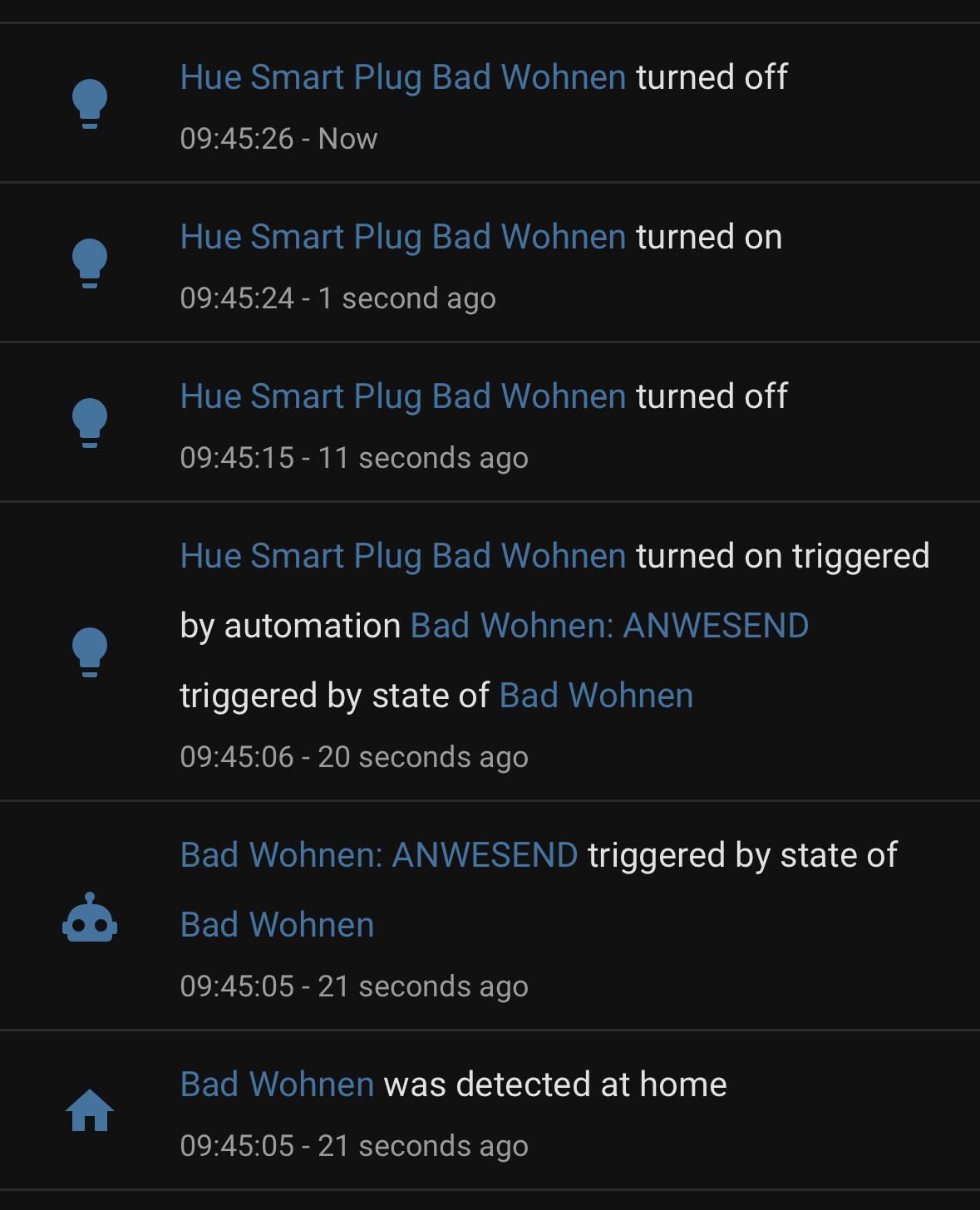

And here’s the log (sorry, can’t post more than one image because I’m new)
