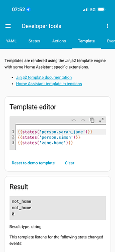

and this is what HA was reporting when no-one was home (i had left the house about 5 minutes earlier - other person had left much earlier than me)
i’m guessing the automation isn’t picking if the change from 1 to 0 in zone.home or something like that, as it appears all the other triggers are correct
Your template editor code references states('zone.home') to get the 0, but your trigger is paying attention to the ‘persons’ attribute of that entity rather than its state.
right, i thought they would both essentially do the same thing.
so persons being below 1 isn’t the same as state being zero?

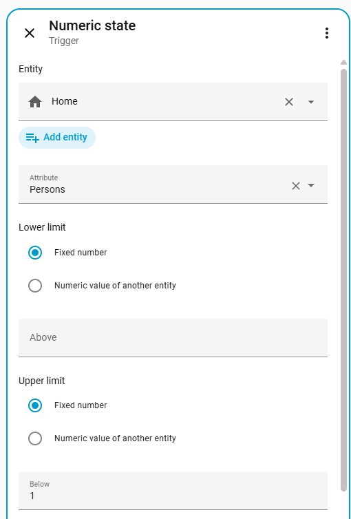

this is what i had set in the UI
It is the same thing.
Just remove the attribute.
The attribute holds the persons that is currently home.

cool, so just remove that attribute and it should just start working?
Yes, the second “line” in the GUI says attribute: persons. Click on the X there
i shall do that.
You should give the solution to Dominic.
His post says the same thing I did but in a different way.
managed to finally test this today in a real world environment and it worked correctly.
