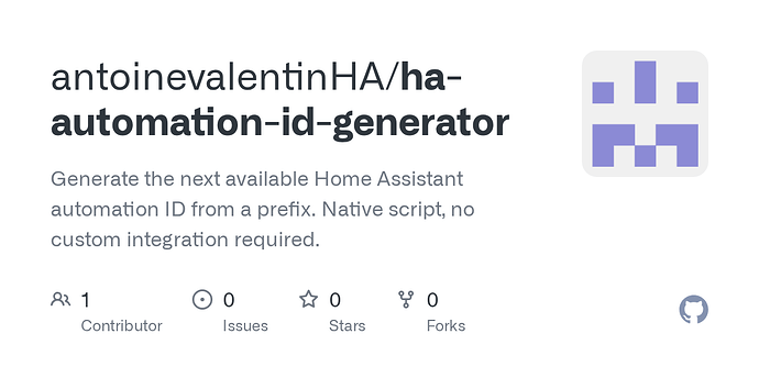

GitHub
Full files and example configuration:
:point_right: GitHub repo
If anyone finds this useful or has improvements, feel free to contribute.
