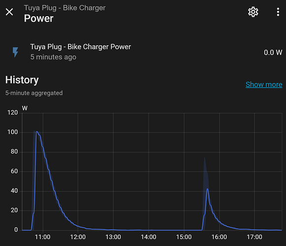

The charger is connected to a power monitoring plug so I have stats for when the charge is pulling electricity from the grid and charging my bikes battery, like so:-
I’d like to create an automation that reminds me to charge the battery if its not been charged within the last 48 hours, and for that reminder to only happen hourly from 7pm until 10pm, or stop when its detected I’ve actually started the charging process.
The time based trigger part is pretty straightforward, but I’m not sure how to construct a template condition to only notify me if there has been no charging (charging is defined as the smart plug recording more than 30 watts of power on the smart plug entity sensor.tuya_plug_bike_charger_active_power for at least 10 minutes (but could be more) and then dropping to 0 watts) in the last (say) 30 hours.
