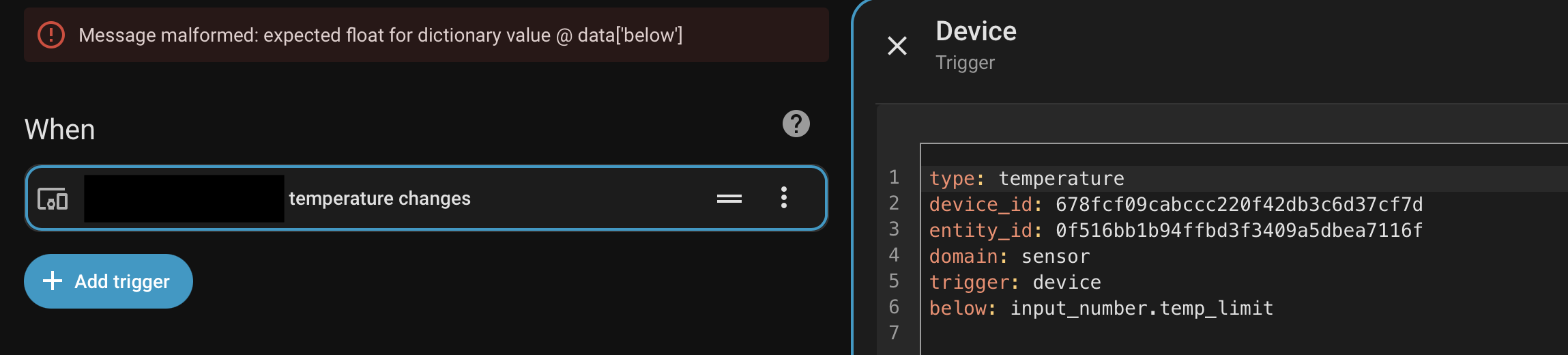

I need some help, I’m a beginner, my knowledge is limited.
I want to create an automation when temperature read from one DS1820 connected to one esp32 reach limit set in one input_number to fire a trigger
I tried some exampled from google but still I receive error message
“Message malformed: expected float for dictionary value @ data[‘below’]”
This is Yaml of my automation
type: temperature
device_id: 678fcf09cabccc220f42db3c6d37cf7d
entity_id: 0f516bb1b94ffbd3f3409a5dbea7116f
domain: sensor
trigger: device
below: input_number.temp_limit
Thanks in advance for any hint
If you want to use an entity in the below option then you need to use a numeric state trigger, not a device trigger.

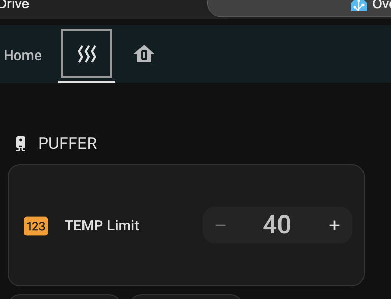

I created one helper, input_number which I want to use for set a limit for temp.

I tried to create one helper for minim temp limit, of 40, because I need to be manual adjustable base on some condition.
For this reason I tried with helper to set for trigger the value

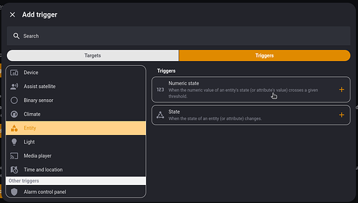

As Tom posted earlier, Device triggers will not let you do that. Use a Numeric State trigger.
In the Automation editor you will find it under the “Entity” section:
Thanks a lot, also Tom, Hellis81 and entire team.
Now I know :))), it works perfectly !
