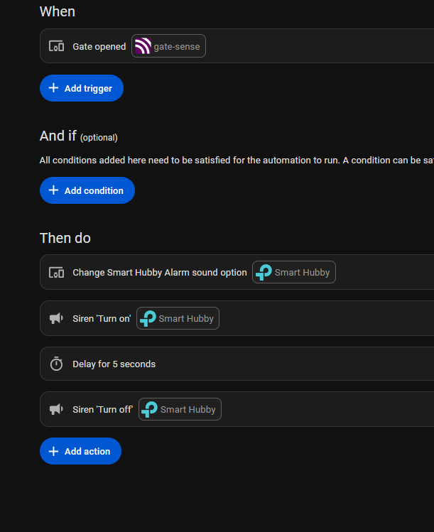

Hi
I have a strange issue just started recently
I have an Automation that keeps Run Action when I restart Homeassistant
This only started few weeks ago, I deleted the automation and re-wrote it but still will run on restart or reboot
Here is the yaml file

This sets a device “SmartHubby” [wife named this] which is a TPlink hub with sound output. to ring whenever the gate is opened

Does the automation run always on startup, or only on startup when the state of the binary sensor is open?
The automation is executed when the gate is opened.
But for some strange reason is also triggered when homeassistant is restarted, this also includes times shen updated
This only started happenjng a few week back. Was nevef the cass before
This led me to replace the gate sensor thinking it may bd problem
I also deleted and re-created the automation
I have similar automations on the windows but they dont get affected
The automations were created using thd UI not YAML
I meant to ask if the automation also triggers unwanted in case your HA restarts, and the gate is closed.
My guess is that the automation is triggered by a state change from unavailable to on (opened). If that is indeed the case, it will only trigger when the gate is open at the time of the restart, and not when the gate is closed.

Hi. I have this working however it always shows the gate is open after add this edit
Is there something else I need to do so it shows that5 the gate has closed again
Also it rings again when the gate is closed
Can you post the full automation you have right now, and also explain more clearly what goes wrong, and what you would have expected to happen.
I found the original problem
Is a broken magnet, somehow broke into 2 pieces and was sitting just on the edge of the sensor position.
So I replaced the magnet I reverted my original automation and all works correctly
I had thought it was the sensor so replaced it, but all my other window and doors were ok. so looked a bit deeper by putting the sensor on my work desk then saw it worked on the desk…
The problem was home assistant was seeing the gate open,
