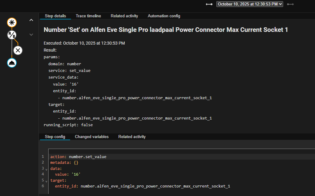

and this is the action that does often not happen:

More importantly, I found out that it seems to be a (common) problem of the integration (or the data servers/API that it uses: Changing entity "power_connector_external_max_current_socket_1" has no effect · Issue #198 · leeyuentuen/alfen_wallbox · GitHub
Please help with a temporary fix, for example to check if the automation’s action has been performed succesfully, and if not, to do it again. Is that possible?
See the repeat until example here:
thank you, I’ll give it a try
