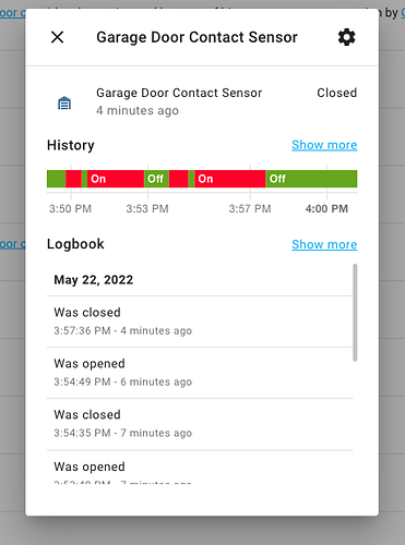

To be sure you are using the correct state, check Developer Tools β€”> States. Binary sensors are on or off (lower case).
Tried and it does not trigger with β€œon” or β€œoff”

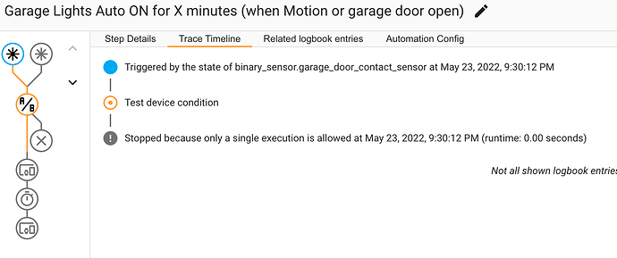

Please check the debug trace.

After a quick google search i got it to work with changing from single to queues.
But why?
Queued
Start a new run after all previous runs complete. Runs are guaranteed to execute in the order they were queued. Note that subsequent queued automations will only join the queue if any conditions it may have are met at the time it is triggered.
Im guessing the condition is_off will mess things up
Maybe it has to do with the gpio platform.
If you suspect the device condition test it with state condition instead.
