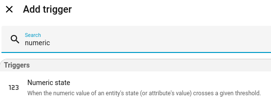

The Numeric State Trigger’s documentation explains how it works. The entity’s state value must cross the threshold value.

Crossing the threshold means that the trigger only fires if the state wasn’t previously within the threshold. If the current state of your entity is 50 and you set the threshold to below: 75, the trigger would not fire if the state changed to e.g. 49 or 72 because the threshold was never crossed. The state would first have to change to e.g. 76 and then to e.g. 74 for the trigger to fire.
The word “crosses” is also used to describe the trigger’s behavior when displayed in the Automation Editor.
