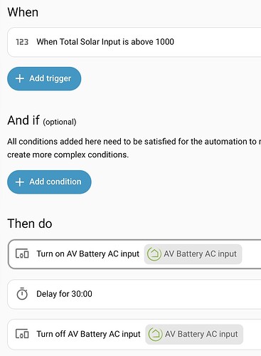

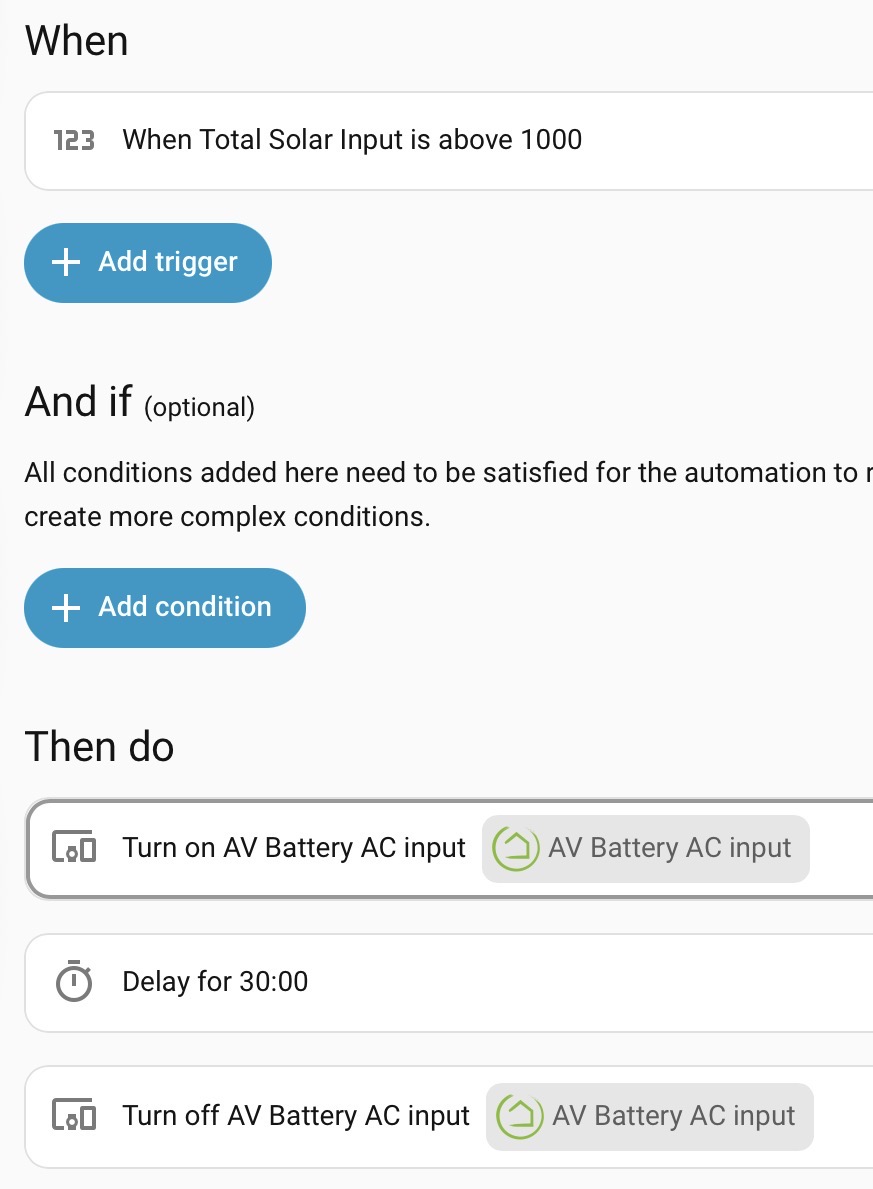

So your basicly looking for something like this?
Something like that yes. Wow thank you for your fast reply.
I could not find the “delay”.
Does the airco stays on when the solar input stays above 1000 after 30 minutes?
Not with the automation i posted, it will not do anything its not been told to do. if that is what you want… remove the delay and the off and choose a better trigger than a 30min delay to turn your AC off, like if solar input is below a value for a period of time in a separate automation.
You can also add conditionals to the “then do” section, but i would start with simple automations. As you become comfortable as simple logic, then go back and edit your automations to be more complicated. Walk before you run.
