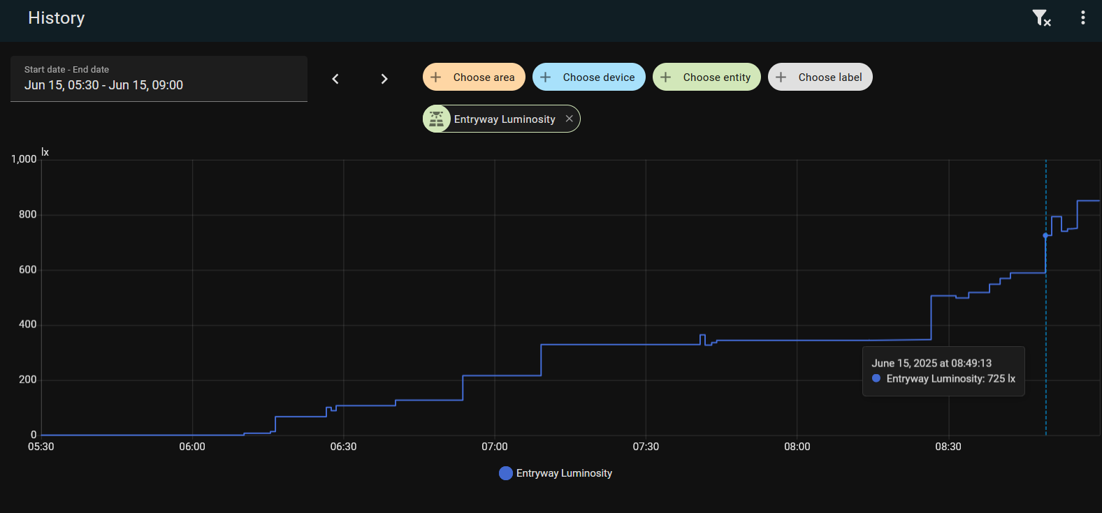

More trigger details;
Recorded luminosity;
at 06:00 = 0
at 06:10 = 7
at 06:15 = 13
at 06:16 = 67
at 06:26 = 101
at 06:40 = 127
at 06:53 = 216
at 07:09 = 329 (now above threshold for all three automations)
at 07:40 = 364
at 08:26 = 506 (now well above threshold and time requirement for all three automations)
all subsequent luminosity values continued to rise far above threshold with no interruptions.
Can you post the luminosity history graph here?
Not sure how to post the history graph directly so I tried inserting it as a screen clip. Hope that is useful.
