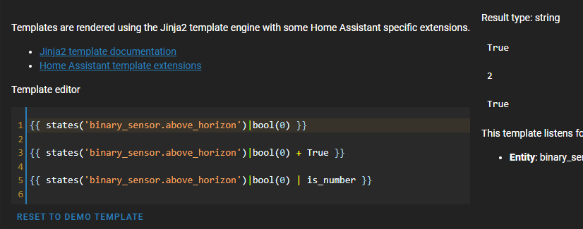

Put this in the template editor:
{{ 'on' | bool(0) }}
{{ 'on' | bool(0) |is_number }}
Hmmm…
I tested this:
so there must be some kind of conversion magic going on in the background?
The conversion of boolean true to integer 1 (false/0) is found in python (and in other languages as well).
For example, the result of this {{ true + true }} is 2.
