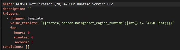

The genset hours ticked over 48 last night and I received a notification for the 4750 service due, but not the 4740 reminder. I looked through the traces of the 4750 automation and the template listed in the “Step Details” and “Automation Config” tabs still had the original template (pictured)
even though when I go view the automation in the GUI editor and .yaml the template is shown as correct.

My question is: Why did the automation trigger based on the original template is was created with instead of the updated template? Could this be because I did not do a restart?
If so, for future, should it be a .yaml restart or a full restart?
Obviously the 4740 reminder automation has no traces as it did not trigger. The 4740 automation was created with the integer comparator initially, so this is why it leads me to think it was a restart issue.
