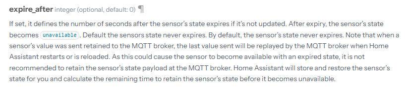

You can set an mqtt entity up to mark itself unavailable if it does not receive an update in a particular time period.
https://www.home-assistant.io/integrations/sensor.mqtt/#expire_after
It would be a lot more efficient to only trigger when the entity becomes unavailable (state trigger) due to exceeding that setting.
Thanks, i adjusted the existing mqtt sensor to have the expire_after and works like a charm.
