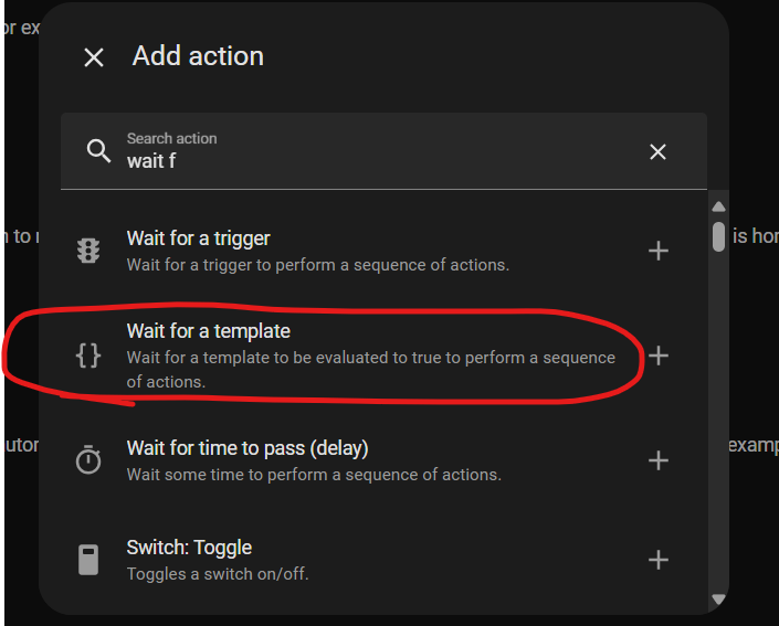

instead of wait for trigger
Unfortunately have got a little lost now. I tried to adjust to be "Wait for a template".but error gets worse and no doubt due to it being iincorrectly implemented as I have no experience with it.
Message malformed: template value should be a string for dictionary value @ data[‘actions’][3][‘wait_template’]
Might have to try from scratch or alternate method, as no idea what I am doing. :woozy_face:
