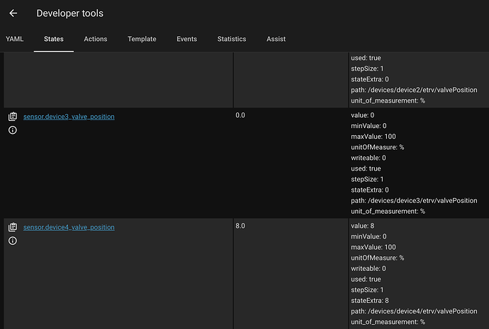

What is sensor.device8? Can you post a screenshot from the Developer Tools > States screen on a computer showing state and attributes columns?
Also why are you complicating things with template conditions when you can use numeric state conditions?

The screenshot you posted shows that the sensors don’t have a valve_position attribute. That explains why your template failed.
According to the screenshot, “valve_position” is text within the entity’s entity_id.
sensor.device8_valve_position
This would have worked.
{{ states('sensor.device8_valve_position') | int(0) < 99 }}

Yeah, that’s why I asked for the screenshot after the template error was posted. Just didn’t make sense.
OP: you can remove the attribute lines — the number you want us in both each sensor’s state and the value attribute.

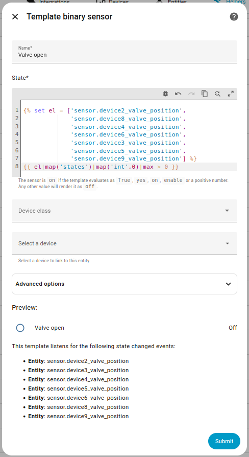

Set up a Template Binary Sensor helper (see below) called “Valve open” with state:
{% set el = ['sensor.device2_valve_position',
             'sensor.device8_valve_position',
             'sensor.device4_valve_position',
             'sensor.device6_valve_position',
             'sensor.device3_valve_position',
             'sensor.device5_valve_position',
             'sensor.device9_valve_position'] %}
{{ el|map('states')|map('int',0)|max > 0 }}
This reports off if all the valves are at 0, and on in any other situation.
The default 0 value in the int filter means that an offline valve will be considered shut. Change the 0 to a positive number if you want an offline value considered open.

Thanks Troon, how do I set up a Template Binary Sensor helper? I looked at Helpers under Devices and services, but I don’t see an edit in yaml option there, so probably the wrong place.
Devices and services > Helpers > Create helper > Template > Binary sensor. That should get you to the blank starting point of my screenshot above.
No YAML involved: the YAML I posted was for the automation. The state template, if that’s what you mean, is a Jinja template and is not YAML.
