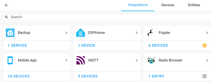

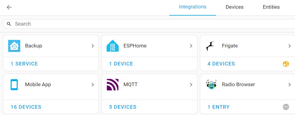

When I click Settings->Devices & services, I see installed integrations like below.

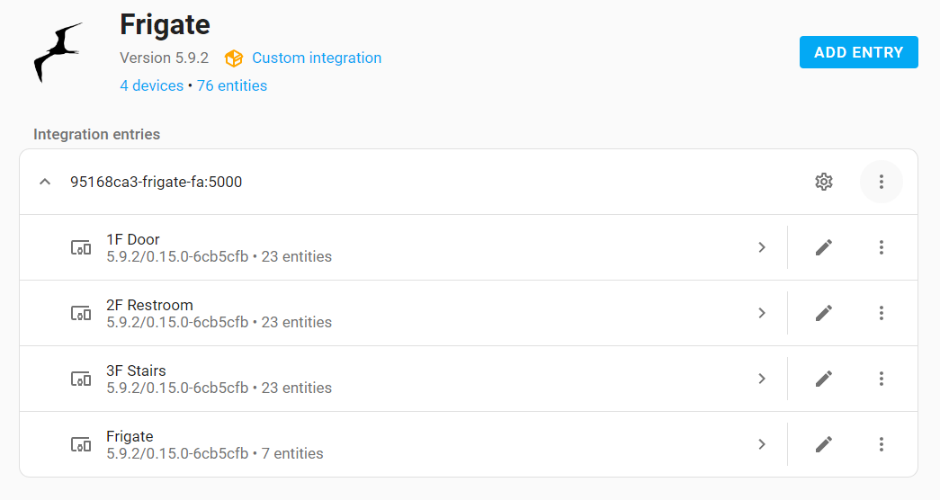

I click Frigate, for example, and I see the one below.

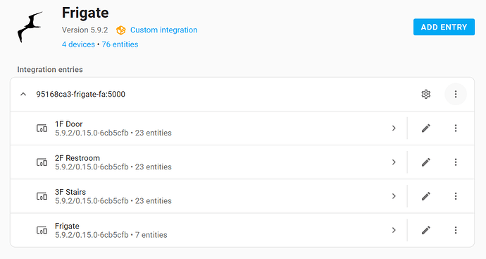

I click three dots on the top right and I see “Disable” as below.
When I click “Disable”, Frigate is disabled and there is no more live feed on lovelace.

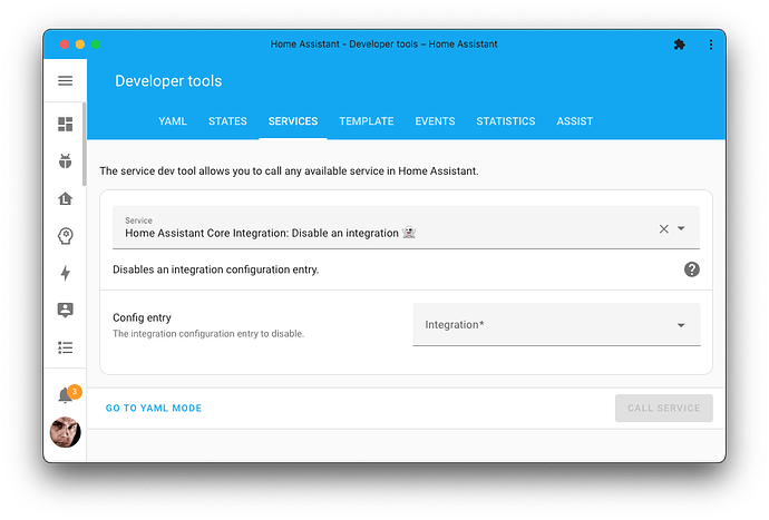

You cannot trust AI to give you sane answers about HA. The Spook integration adds the functionality you seek:

The tricky bit is to find the config_entry_id :stuck_out_tongue:
I’ve done this by going to the Developer Tools, select the UI Mode, type in ‘homeassistant.disable_config_entry’ as the action and select the device from the dropdown menu.
Once you’ve done this, switch to YAML Mode and you’ll see the config_entry_id here:
action: homeassistant.disable_config_entry
  config_entry_id: 98377f1234567f4bb2092ce331bd41adaa
Or you use
config_entry_id: "{{ config_entry_id('some entity id provided by the integration you want to disable') }}"
