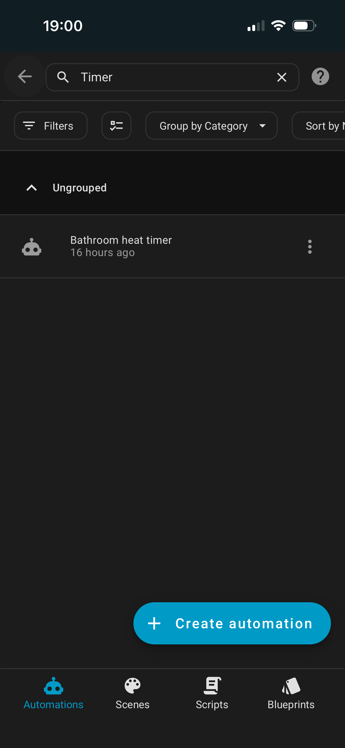

Today I went to investigate an automation that seems to be misbehaving, and I found that all its recent traces are missing. This automation runs daily on a timer, and I can tell it is definitely running because the heater is turning on when it should. (And because the log book show it ran). But the last trace showing is from a week ago.
I checked the log from the time when it ran and didn’t see anything relevant. How can I troubleshoot this further?

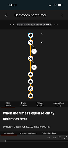

They need more recent ones, not older traces. The right arrow is greyed out in the screenshot, meaning that the latest trace they have is from 10 days ago.
Increasing the stored traces won’t help if the missing traces are the most recent ones
Then it didn’t run.
